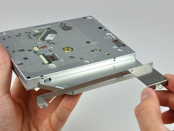

  15. PowerBook G4 Aluminum 17" 1.67 GHz (High-Res) Optical Drive Replacement: crwdns2935265:015crwdnd2935265:01crwdnd2935265:02crwdne2935265:0 PowerBook G4 Aluminum 17" 1.67 GHz (High-Res) Optical Drive Replacement: crwdns2935265:015crwdnd2935265:02crwdnd2935265:02crwdne2935265:0
    • Remove the two Phillips screws holding the optical drive bracket to the side of the optical drive.
    • Pull the optical drive bracket away from the thin side of the optical drive.

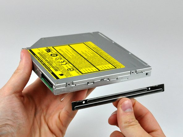

  16. PowerBook G4 Aluminum 17" 1.67 GHz (High-Res) Optical Drive Replacement: crwdns2935265:016crwdnd2935265:01crwdnd2935265:02crwdne2935265:0 PowerBook G4 Aluminum 17" 1.67 GHz (High-Res) Optical Drive Replacement: crwdns2935265:016crwdnd2935265:02crwdnd2935265:02crwdne2935265:0
    • Remove the two Phillips screws securing the flat optical drive bracket to the side of the optical drive.
    • Remove the optical drive bracket.
    • If you have a disk or anything else stuck inside your optical drive, we have a guide to fix it.
