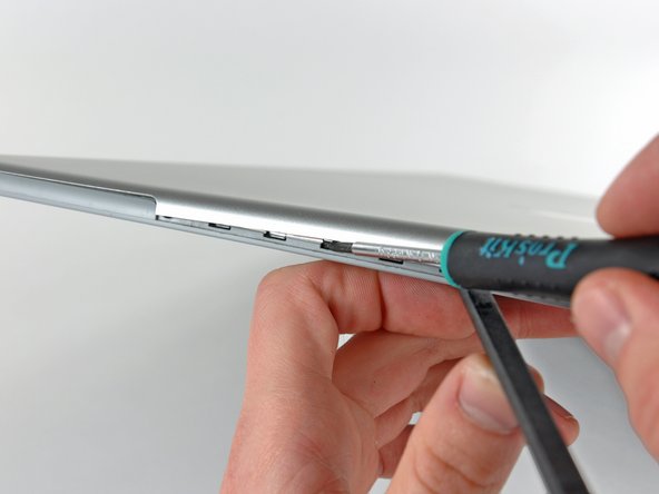

  38. PowerBook G4 Aluminum 17" 1.67 GHz (High-Res) Clutch Hinges Replacement: crwdns2935265:038crwdnd2935265:01crwdnd2935265:03crwdne2935265:0 PowerBook G4 Aluminum 17" 1.67 GHz (High-Res) Clutch Hinges Replacement: crwdns2935265:038crwdnd2935265:02crwdnd2935265:03crwdne2935265:0 PowerBook G4 Aluminum 17" 1.67 GHz (High-Res) Clutch Hinges Replacement: crwdns2935265:038crwdnd2935265:03crwdnd2935265:03crwdne2935265:0
    • Insert the flat end of a spudger between the front display bezel and the plastic rim attached to the rear bezel near the lower right corner of the display.
    • Do not try to insert the spudger between the front display bezel and its plastic surround.
    • While carefully prying the rear display bezel away from the display assembly, use a small flathead screwdriver to pry the small steel clip nearest the bottom right corner of the display away from the edge of the front display bezel.
    • Repeat the above procedure until you've released all the clips along the right side of the display.

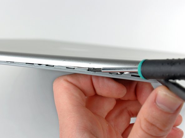

  40. PowerBook G4 Aluminum 17" 1.67 GHz (High-Res) Clutch Hinges Replacement: crwdns2935265:040crwdnd2935265:01crwdnd2935265:01crwdne2935265:0
    • Insert the flat end of a spudger between the rear display bezel and the plastic surround of the front display bezel near the lower left corner of the display.
    • Carefully pry the rear display bezel away from the front display bezel to release a metal clip.
  41. PowerBook G4 Aluminum 17" 1.67 GHz (High-Res) Clutch Hinges Replacement: crwdns2935265:041crwdnd2935265:01crwdnd2935265:01crwdne2935265:0
    • Repeat the previous procedure to release the clips along the left side of the rear display bezel.

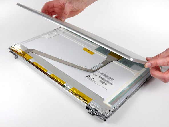

  42. PowerBook G4 Aluminum 17" 1.67 GHz (High-Res) Clutch Hinges Replacement: crwdns2935265:042crwdnd2935265:01crwdnd2935265:02crwdne2935265:0 PowerBook G4 Aluminum 17" 1.67 GHz (High-Res) Clutch Hinges Replacement: crwdns2935265:042crwdnd2935265:02crwdnd2935265:02crwdne2935265:0
    • Slightly lift the lower edge of the rear display bezel and push it toward the top edge of the display, releasing the clips along the top edge of the rear display bezel.
    • Remove the rear display bezel and set it aside.

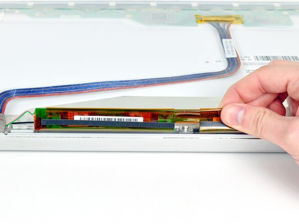

  43. PowerBook G4 Aluminum 17" 1.67 GHz (High-Res) Clutch Hinges Replacement, Display Inverter: crwdns2935265:043crwdnd2935265:01crwdnd2935265:01crwdne2935265:0
    • If present, remove the pieces of tape along the bottom edge of the LCD.
  44. PowerBook G4 Aluminum 17" 1.67 GHz (High-Res) Clutch Hinges Replacement: crwdns2935265:044crwdnd2935265:01crwdnd2935265:02crwdne2935265:0 PowerBook G4 Aluminum 17" 1.67 GHz (High-Res) Clutch Hinges Replacement: crwdns2935265:044crwdnd2935265:02crwdnd2935265:02crwdne2935265:0
    • Use the tip of a spudger to lift the display inverter enough to grab it with your fingers.
    • Lift the display inverter out of the clutch hinges enough to access both of its connectors.

    • Disconnect the inverter cable from its socket on the display inverter.
  46. PowerBook G4 Aluminum 17" 1.67 GHz (High-Res) Clutch Hinges Replacement: crwdns2935265:046crwdnd2935265:01crwdnd2935265:01crwdne2935265:0
    • Disconnect the backlight cable from its socket on the display inverter.
  47. PowerBook G4 Aluminum 17" 1.67 GHz (High-Res) Clutch Hinges Replacement: crwdns2935265:047crwdnd2935265:01crwdnd2935265:01crwdne2935265:0
    • Remove the inverter from the display.

    • Use the tip of a spudger to remove the gray plastic end cap from the inverter cable side of the clutch hinges.
