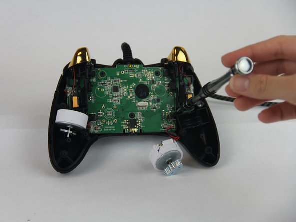

    • Take off the glue that is on top of the soldered joints with a sprudger.
    • Desolder the soldered joints of the red and black wires that are connecting the vibration motors to the motherboard.
    • Remove the vibration motors and put them aside.
    • This guide will show how to solder and desolder connections.
  4. PowerA Fusion Controller For Xbox One Motherboard Replacement, Motherboard: crwdns2935265:04crwdnd2935265:01crwdnd2935265:03crwdne2935265:0 PowerA Fusion Controller For Xbox One Motherboard Replacement, Motherboard: crwdns2935265:04crwdnd2935265:02crwdnd2935265:03crwdne2935265:0 PowerA Fusion Controller For Xbox One Motherboard Replacement, Motherboard: crwdns2935265:04crwdnd2935265:03crwdnd2935265:03crwdne2935265:0
    • Remove the five 9.2mm screws with a JIS #1 screwdriver. Indicated by the red circles.
    • Lift the motherboard and let it hang.
  5. PowerA Fusion Controller For Xbox One Motherboard Replacement: crwdns2935265:05crwdnd2935265:01crwdnd2935265:02crwdne2935265:0 PowerA Fusion Controller For Xbox One Motherboard Replacement: crwdns2935265:05crwdnd2935265:02crwdnd2935265:02crwdne2935265:0
    • Remove the four 9.2mm screws that are holding the D-Pad to the controller housing. Indicated by the red circles.
    • Remove the motherboard.
