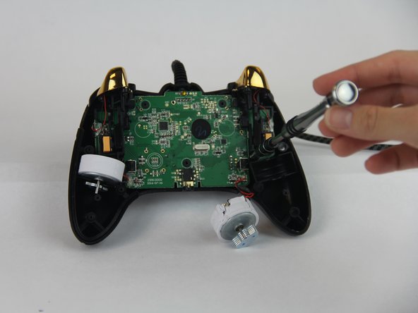

    • Remove the (9) nine 9.2mm screws with a JIS #1 screwdriver.
    • Remove the two bottom plastic grip covers.
  2. PowerA Fusion Controller For Xbox One Buttons Replacement: crwdns2935265:02crwdnd2935265:01crwdnd2935265:02crwdne2935265:0 PowerA Fusion Controller For Xbox One Buttons Replacement: crwdns2935265:02crwdnd2935265:02crwdnd2935265:02crwdne2935265:0
    • Remove the (2) two 9.2mm screws with a JIS #1 screwdriver.
    • Remove the back cover of the controller.

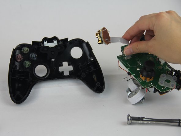

  3. PowerA Fusion Controller For Xbox One Buttons Replacement: crwdns2935265:03crwdnd2935265:01crwdnd2935265:03crwdne2935265:0 PowerA Fusion Controller For Xbox One Buttons Replacement: crwdns2935265:03crwdnd2935265:02crwdnd2935265:03crwdne2935265:0 PowerA Fusion Controller For Xbox One Buttons Replacement: crwdns2935265:03crwdnd2935265:03crwdnd2935265:03crwdne2935265:0
    • Remove the (5) five 9.2mm screws with a JIS #1 screwdriver.
    • Lift the motherboard and let it hang.

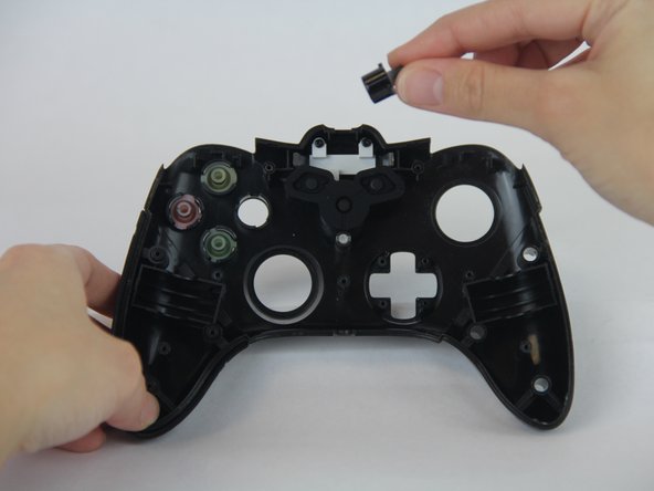

  5. PowerA Fusion Controller For Xbox One Buttons Replacement: crwdns2935265:05crwdnd2935265:01crwdnd2935265:02crwdne2935265:0 PowerA Fusion Controller For Xbox One Buttons Replacement: crwdns2935265:05crwdnd2935265:02crwdnd2935265:02crwdne2935265:0
    • Remove the buttons.

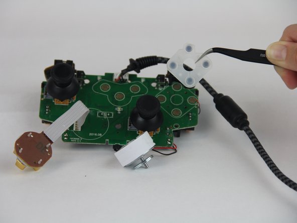

  6. PowerA Fusion Controller For Xbox One Buttons Replacement: crwdns2935265:06crwdnd2935265:01crwdnd2935265:02crwdne2935265:0 PowerA Fusion Controller For Xbox One Buttons Replacement: crwdns2935265:06crwdnd2935265:02crwdnd2935265:02crwdne2935265:0
    • Go back to the motherboard, and remove the buttons' gasket with a tweezler.
