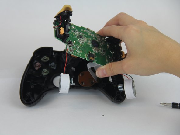

  3. PowerA Fusion Controller For Xbox One Analog Stick Replacement: crwdns2935265:03crwdnd2935265:01crwdnd2935265:03crwdne2935265:0 PowerA Fusion Controller For Xbox One Analog Stick Replacement: crwdns2935265:03crwdnd2935265:02crwdnd2935265:03crwdne2935265:0 PowerA Fusion Controller For Xbox One Analog Stick Replacement: crwdns2935265:03crwdnd2935265:03crwdnd2935265:03crwdne2935265:0
    • Carefully remove the (5) five 9.2mm screws holding the motherboard with a JIS #1 screwdriver.
    • Lift the motherboard and rest it face up to the right of the controller front plate.

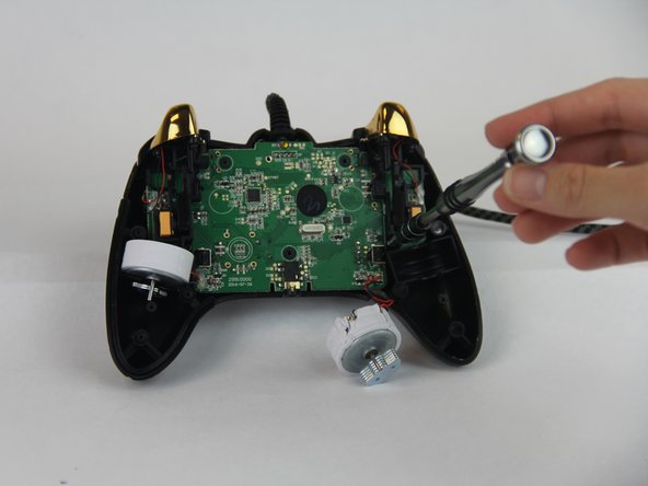

  4. PowerA Fusion Controller For Xbox One Analog Stick Replacement: crwdns2935265:04crwdnd2935265:01crwdnd2935265:02crwdne2935265:0 PowerA Fusion Controller For Xbox One Analog Stick Replacement: crwdns2935265:04crwdnd2935265:02crwdnd2935265:02crwdne2935265:0
    • Remove the (4) four 9.2mm screws that are holding the motherboard to the controller.
    • Remove the motherboard from the face plate of the controller.

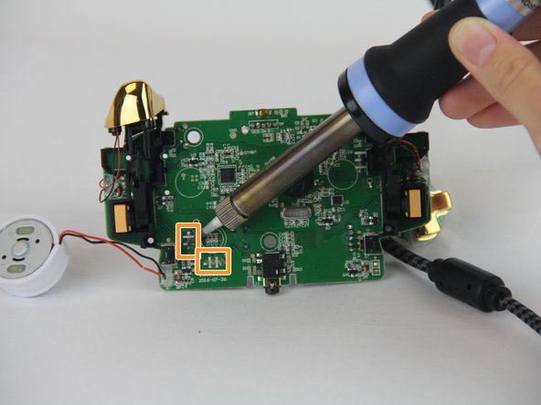

  5. PowerA Fusion Controller For Xbox One Analog Stick Replacement: crwdns2935265:05crwdnd2935265:01crwdnd2935265:02crwdne2935265:0 PowerA Fusion Controller For Xbox One Analog Stick Replacement: crwdns2935265:05crwdnd2935265:02crwdnd2935265:02crwdne2935265:0
    • Use the tweezers to unclip the (4) four metal teeth of the analog stick.
    • Use the soldering iron and desoldering braid to desolder the analog stick sensor module from the back of the motherboard.
    • Place the new analog stick sensor module and solder it back.
    • Use the How To Solder and Desolder Connections guide on iFixit to help in desoldering and soldering the analog stick sensor module.
