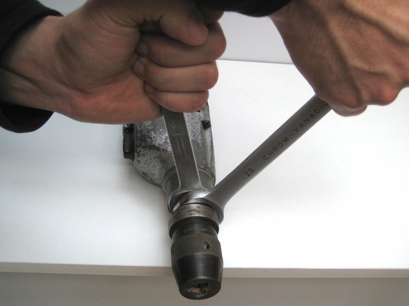

  4. Power Drill Chuck Replacement, Twin Wrench Method: crwdns2935265:04crwdnd2935265:01crwdnd2935265:03crwdne2935265:0 Power Drill Chuck Replacement, Twin Wrench Method: crwdns2935265:04crwdnd2935265:02crwdnd2935265:03crwdne2935265:0 Power Drill Chuck Replacement, Twin Wrench Method: crwdns2935265:04crwdnd2935265:03crwdnd2935265:03crwdne2935265:0

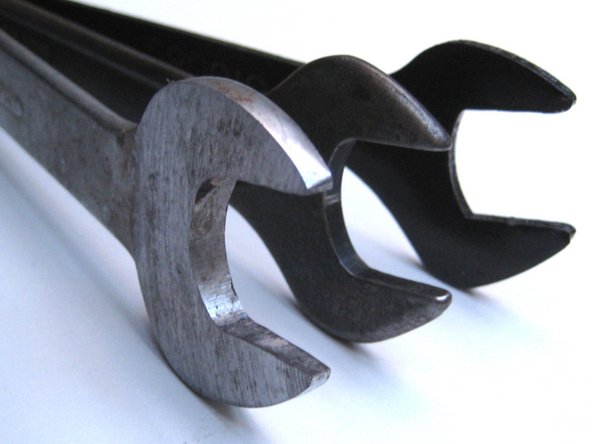

    • If both the spindle and the chuck have some provision that allows the use of a wrench, it's your lucky day!
    • In some cases, you may need to use a thin wrench (or grind down a regular one) as there may not be sufficient space to fit a regular size wrench.
    • Unlike the retaining screw, the chuck is held on with a regular right-hand thread. Turn counter-clockwise to remove.
    • With the opposing action of two wrenches, even the most stubborn of chucks should come loose.

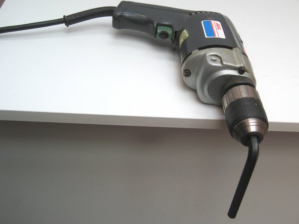

    • If the chuck has no provision for a wrench, the easiest way to turn it forcefully is by means of a hex key gripped in the chuck jaws by its short end.
    • If a wrench can be fitted to the spindle, lay the drill flat on the edge of a workbench or sturdy table, with the wrench resting on the table, the chuck overhanging the edge and the hex key pointing slightly upwards from horizontal.
    • It won't hurt to try if you can release the chuck by pushing down on the hex key by hand - though this will rarely work.
    • If hand force isn't sufficient, firmly hold down the drill and give the end of the hex wrench a solid whack, preferably with a wooden or plastic hammer. A sharp blow should loosen the chuck instantly.

    • For cordless drills and low speed/high torque corded models, an alternative to the No Wrench Method is to grip the hex key in a vise, put the drill in reverse, hold it tightly with both hands and squeeze the trigger.
    • However this method is not for beginners as it is not without risk: the reaction torque could hurt your wrist and the locked rotor current could burn out the drill motor.
    • If the drill has a mechanical speed selector and/or clutch, make sure to set the gear to the lowest speed and/or the clutch to the highest setting.

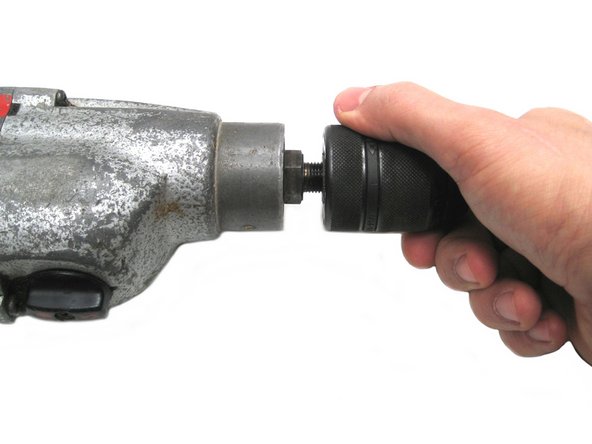

  9. Power Drill Chuck Replacement, Fitting a New Chuck: crwdns2935265:09crwdnd2935265:01crwdnd2935265:02crwdne2935265:0 Power Drill Chuck Replacement, Fitting a New Chuck: crwdns2935265:09crwdnd2935265:02crwdnd2935265:02crwdne2935265:0
    • If there's no retaining screw and you anticipate forceful counterclockwise action (as when unscrewing), apply a small amount of threadlocking compound to the spindle thread.
    • Use a medium-strength variety, not the kind you'll have to heat with a blowtorch if you need to take off the chuck again at a later stage!
    • Screw the chuck onto the spindle as far as it will go. You don't need to tighten it with excessive force, it will tighten itself with normal use.
