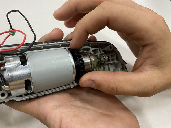

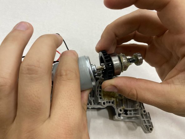

  8. Porter-Cable PCC710B Motor Replacement, Eccentric shaft: crwdns2935265:08crwdnd2935265:01crwdnd2935265:03crwdne2935265:0 Porter-Cable PCC710B Motor Replacement, Eccentric shaft: crwdns2935265:08crwdnd2935265:02crwdnd2935265:03crwdne2935265:0 Porter-Cable PCC710B Motor Replacement, Eccentric shaft: crwdns2935265:08crwdnd2935265:03crwdnd2935265:03crwdne2935265:0
    • Gently pull the motor out of the case.
    • To remove the eccentric shaft simply pull it off of the motor.
    • When replacing the eccentric shaft, you must grease it before the install or else it'll overheat and break. The black fan shaped part of the eccentric shaft should slide onto the thin rod of the motor until it clicks securely.

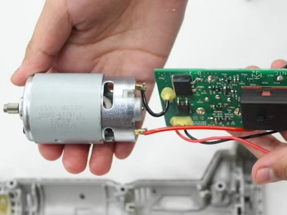

  9. Porter-Cable PCC710B Motor Replacement, Motor: crwdns2935265:09crwdnd2935265:01crwdnd2935265:03crwdne2935265:0 Porter-Cable PCC710B Motor Replacement, Motor: crwdns2935265:09crwdnd2935265:02crwdnd2935265:03crwdne2935265:0 Porter-Cable PCC710B Motor Replacement, Motor: crwdns2935265:09crwdnd2935265:03crwdnd2935265:03crwdne2935265:0
    • Gently remove the motor with your hands.
    • You'll have to pull out the circuit board and all of its connections too in order to properly work on the motor.
    • Be gentle, everything will come out easily without much effort.

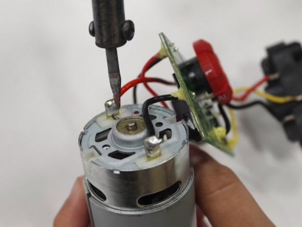

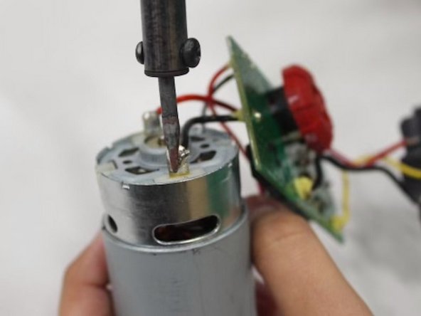

  10. Porter-Cable PCC710B Motor Replacement: crwdns2935265:010crwdnd2935265:01crwdnd2935265:03crwdne2935265:0 Porter-Cable PCC710B Motor Replacement: crwdns2935265:010crwdnd2935265:02crwdnd2935265:03crwdne2935265:0 Porter-Cable PCC710B Motor Replacement: crwdns2935265:010crwdnd2935265:03crwdnd2935265:03crwdne2935265:0
    • You'll need your soldering equipment for the remaining steps.
    • Desolder the red wire from the motor and then the black wire.
    • Once the solder connection melts, pull the wires from the motor.
    • Once both connections are severed, wait 2-3 minutes for the ends of the wires to cool before handling them!
