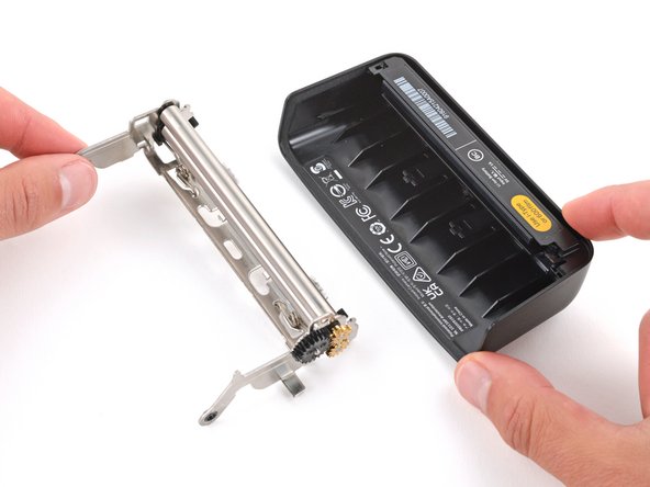

  18. Polaroid Now Gen 3 Print Roller Replacement, Remove the print roller screw: crwdns2935265:018crwdnd2935265:01crwdnd2935265:02crwdne2935265:0 Polaroid Now Gen 3 Print Roller Replacement, Remove the print roller screw: crwdns2935265:018crwdnd2935265:02crwdnd2935265:02crwdne2935265:0
    Phillips #00 Screwdriver
    $5.49
    • Use a Phillips screwdriver to remove the 3.9 mm‑long screw securing the print roller.
    • You may need to use a flashlight to see the screw, as well as a skinny, long‑shank screwdriver to reach it.
  19. Polaroid Now Gen 3 Print Roller Replacement, Unclip the print roller: crwdns2935265:019crwdnd2935265:01crwdnd2935265:03crwdne2935265:0 Polaroid Now Gen 3 Print Roller Replacement, Unclip the print roller: crwdns2935265:019crwdnd2935265:02crwdnd2935265:03crwdne2935265:0 Polaroid Now Gen 3 Print Roller Replacement, Unclip the print roller: crwdns2935265:019crwdnd2935265:03crwdnd2935265:03crwdne2935265:0
    • Two plastic tabs secure the center of the print roller.
    • Use the tip of a spudger to depress both plastic tabs until their hooks release from the print roller—you'll hear an audible "click."
  20. Polaroid Now Gen 3 Print Roller Replacement, Remove the print roller: crwdns2935265:020crwdnd2935265:01crwdnd2935265:03crwdne2935265:0 Polaroid Now Gen 3 Print Roller Replacement, Remove the print roller: crwdns2935265:020crwdnd2935265:02crwdnd2935265:03crwdne2935265:0 Polaroid Now Gen 3 Print Roller Replacement, Remove the print roller: crwdns2935265:020crwdnd2935265:03crwdnd2935265:03crwdne2935265:0
    • Grab the print roller by one of its arms and pull it straight out of its plastic housing.
    • Pull straight away from the housing to avoid bending or warping the metal.
    • If you're having trouble, make sure the clips are released. You may have to hold the clips down while pulling.
  21. Polaroid Now Gen 3 Print Roller Replacement: crwdns2935265:021crwdnd2935265:01crwdnd2935265:03crwdne2935265:0 Polaroid Now Gen 3 Print Roller Replacement: crwdns2935265:021crwdnd2935265:02crwdnd2935265:03crwdne2935265:0 Polaroid Now Gen 3 Print Roller Replacement: crwdns2935265:021crwdnd2935265:03crwdnd2935265:03crwdne2935265:0
    • The print roller is a sensitive component. Be extremely careful during reassembly to not bend or warp the metal.
    • During reassembly, note the following to properly reinsert the print roller into its plastic housing:
    • Two metal L-shaped rails at the bottom of the print roller need to slide under cutouts in the plastic housing.
    • Two metal hooks at the top of the print roller need to fit under the top corners of the plastic housing.
    • Insert the print roller at a downward angle to fit the hooks in first before sliding the rails into place.
    • Push the print roller into its plastic housing until you hear the plastic tabs click back into place.
