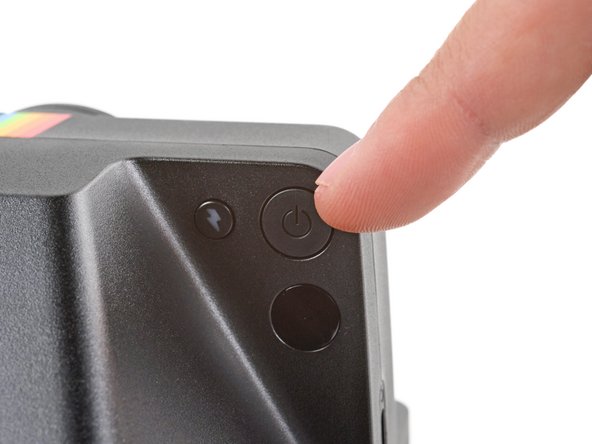

    • Before you begin, unplug and fully power down your camera.

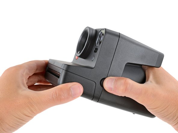

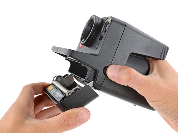

  2. How to Clean the Rollers in Your Polaroid Now (Gen 3) Camera, Open the film door: crwdns2935265:02crwdnd2935265:01crwdnd2935265:03crwdne2935265:0 How to Clean the Rollers in Your Polaroid Now (Gen 3) Camera, Open the film door: crwdns2935265:02crwdnd2935265:02crwdnd2935265:03crwdne2935265:0 How to Clean the Rollers in Your Polaroid Now (Gen 3) Camera, Open the film door: crwdns2935265:02crwdnd2935265:03crwdnd2935265:03crwdne2935265:0
    • Hold down the latch on the left side of the camera and open the film door.

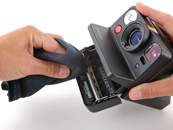

  3. How to Clean the Rollers in Your Polaroid Now (Gen 3) Camera, Clean the rollers: crwdns2935265:03crwdnd2935265:01crwdnd2935265:02crwdne2935265:0 How to Clean the Rollers in Your Polaroid Now (Gen 3) Camera, Clean the rollers: crwdns2935265:03crwdnd2935265:02crwdnd2935265:02crwdne2935265:0
    • Lightly dampen a soft, clean cloth with water.
    • Use the cloth to gently clean the entire surface of both rollers, spinning them as necessary.
    • Allow the rollers to dry completely before using your camera again.
If cleaning the rollers doesn't solve your problem, they may be damaged. Follow this guide to replace the printer roller itself, or this guide to replace the film door (which contains the rollers).
