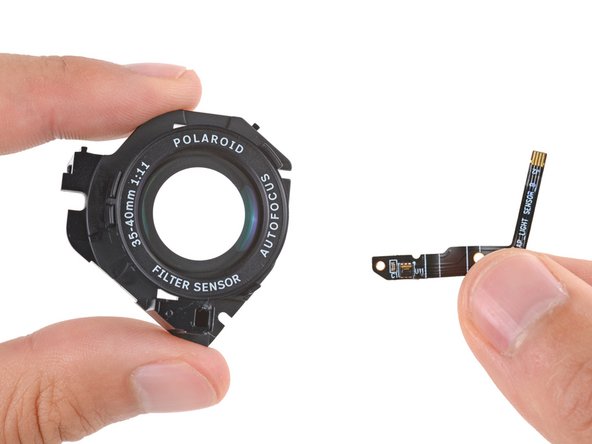

  31. Polaroid Now Gen 3 Outer Lens Replacement, Compare your replacement part: crwdns2935265:031crwdnd2935265:01crwdnd2935265:02crwdne2935265:0 Polaroid Now Gen 3 Outer Lens Replacement, Compare your replacement part: crwdns2935265:031crwdnd2935265:02crwdnd2935265:02crwdne2935265:0
    • Check if your replacement lens has a light sensor installed.
    • If it doesn't, carefully remove it from your original lens and transfer it to the new one.
    • The cable is lightly glued in place and should come off easily.
