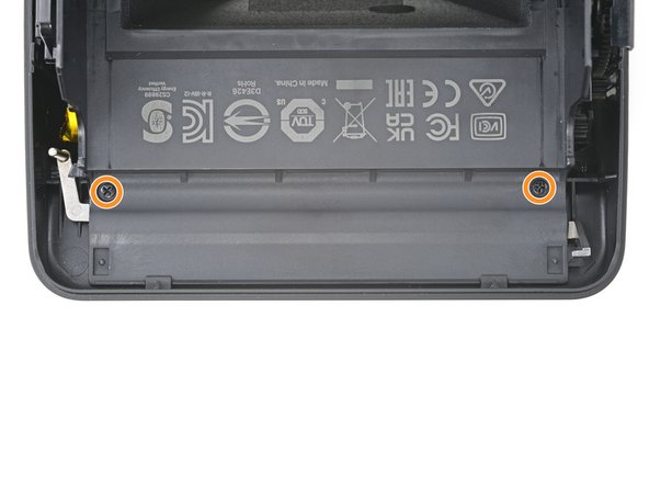

  24. Polaroid I-2 USB-C Port Board Replacement, Unfasten the top cover: crwdns2935265:024crwdnd2935265:01crwdnd2935265:03crwdne2935265:0 Polaroid I-2 USB-C Port Board Replacement, Unfasten the top cover: crwdns2935265:024crwdnd2935265:02crwdnd2935265:03crwdne2935265:0 Polaroid I-2 USB-C Port Board Replacement, Unfasten the top cover: crwdns2935265:024crwdnd2935265:03crwdnd2935265:03crwdne2935265:0
    • Use a Phillips screwdriver to remove the two 3.9 mm-long screws securing the top cover.

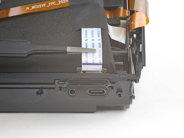

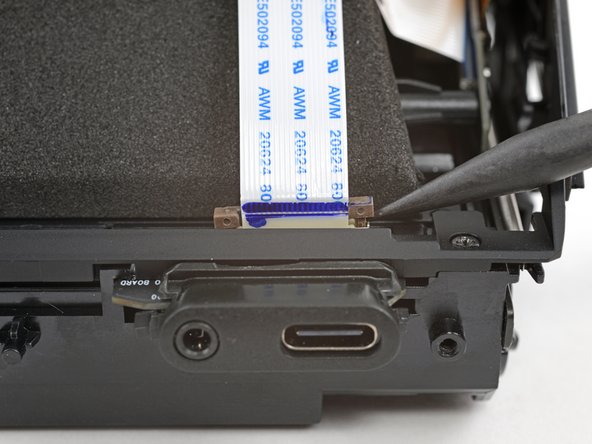

  33. Polaroid I-2 USB-C Port Board Replacement, Disconnect the USB-C port board: crwdns2935265:033crwdnd2935265:01crwdnd2935265:03crwdne2935265:0 Polaroid I-2 USB-C Port Board Replacement, Disconnect the USB-C port board: crwdns2935265:033crwdnd2935265:02crwdnd2935265:03crwdne2935265:0 Polaroid I-2 USB-C Port Board Replacement, Disconnect the USB-C port board: crwdns2935265:033crwdnd2935265:03crwdnd2935265:03crwdne2935265:0
    • Use the tip of a spudger to lift up the two sides of the locking tab on the USB‑C port board cable connector.
  34. Polaroid I-2 USB-C Port Board Replacement: crwdns2935265:034crwdnd2935265:01crwdnd2935265:02crwdne2935265:0 Polaroid I-2 USB-C Port Board Replacement: crwdns2935265:034crwdnd2935265:02crwdnd2935265:02crwdne2935265:0
    • Use tweezers to pull the USB-C port board cable connector out of its socket.

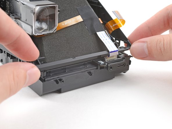

  35. Polaroid I-2 USB-C Port Board Replacement, Unfasten the front cover: crwdns2935265:035crwdnd2935265:01crwdnd2935265:02crwdne2935265:0 Polaroid I-2 USB-C Port Board Replacement, Unfasten the front cover: crwdns2935265:035crwdnd2935265:02crwdnd2935265:02crwdne2935265:0
    • Use a Phillips screwdriver to remove the four screws securing the front cover:
    • Two 5.9 mm-long screws along the back edge of the front cover
    • Flip your camera over.
    • Two 3.9 mm-long screws under the front of the camera
  36. Polaroid I-2 USB-C Port Board Replacement, Reposition the front cover: crwdns2935265:036crwdnd2935265:01crwdnd2935265:02crwdne2935265:0 Polaroid I-2 USB-C Port Board Replacement, Reposition the front cover: crwdns2935265:036crwdnd2935265:02crwdnd2935265:02crwdne2935265:0
    • Lift the back edge of the front cover up enough for the USB-C port board to slide underneath it.

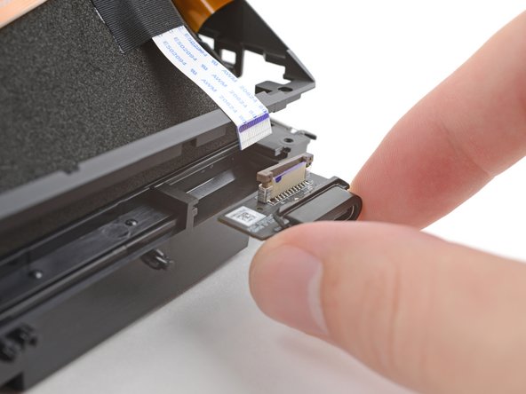

  37. Polaroid I-2 USB-C Port Board Replacement, Remove the USB-C port: crwdns2935265:037crwdnd2935265:01crwdnd2935265:02crwdne2935265:0 Polaroid I-2 USB-C Port Board Replacement, Remove the USB-C port: crwdns2935265:037crwdnd2935265:02crwdnd2935265:02crwdne2935265:0
    • Pull the USB-C port board straight out of its slot in the frame and remove it.
    • During reassembly, align the board properly in its slot in the frame before sliding back into place.

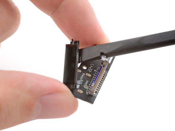

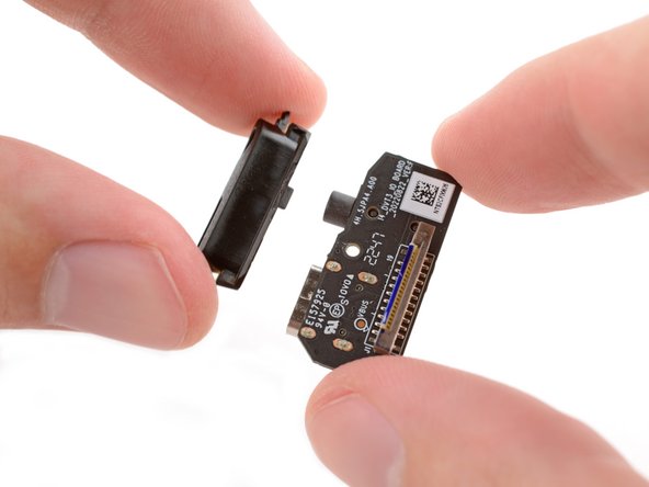

  38. Polaroid I-2 USB-C Port Board Replacement, Remove the plastic cover: crwdns2935265:038crwdnd2935265:01crwdnd2935265:03crwdne2935265:0 Polaroid I-2 USB-C Port Board Replacement, Remove the plastic cover: crwdns2935265:038crwdnd2935265:02crwdnd2935265:03crwdne2935265:0 Polaroid I-2 USB-C Port Board Replacement, Remove the plastic cover: crwdns2935265:038crwdnd2935265:03crwdnd2935265:03crwdne2935265:0
    • The plastic cover is secured to the USB‑C port board with an alignment peg.
    • Insert the flat end of a spudger between the plastic cover and the top of the USB-C port board, above the 2.5 mm jack.
    • Twist the spudger to lift the alignment peg out of its slot in the board.
    • Pull the plastic cover off the USB-C port board.
