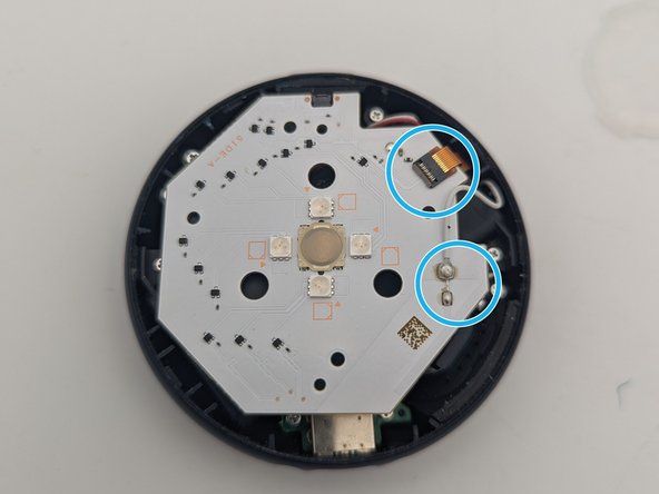

  3. Pokémon™ GO Plus+ Light Dampening, Remove Light PCB from Faceplate: crwdns2935265:03crwdnd2935265:01crwdnd2935265:02crwdne2935265:0 Pokémon™ GO Plus+ Light Dampening, Remove Light PCB from Faceplate: crwdns2935265:03crwdnd2935265:02crwdnd2935265:02crwdne2935265:0
    • Once you've got the faceplate off, on the backside of the faceplate you will see a white PCB with 4 J00 screws securing it, remove those 4 screws
    • There are two alignment posts holding the board in place, while removing the board be careful not to damage these posts
    • These screws go into plastic, so when reassembling at this step, be very careful not to overtighten them
    • While the flat flex cable can be disconnected, the white wire is soldered to the other side of the board, so be very careful to not damage it.
    • For this guide we are not disconnecting either cable, simply be aware they're there and be cautious of them

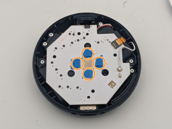

  4. Pokémon™ GO Plus+ Light Dampening: crwdns2935265:04crwdnd2935265:01crwdnd2935265:02crwdne2935265:0 Pokémon™ GO Plus+ Light Dampening: crwdns2935265:04crwdnd2935265:02crwdnd2935265:02crwdne2935265:0
    • Once you remove the PCB from the faceplate you'll have access to the RGB LEDs that make up the center button light.
    • Cut to size whatever you're using to dampen the LEDs, and apply them to each of the 4 LEDs.
    • In the image example, I'm using blue painters tape simply for demonstration purposes. Please note this is not strong enough to meaningfully dampen the light from these LEDs. When you perform this use something stronger.

Is there a way to get rid of the LEDS all together
Chris Menjivar - crwdns2934203:0crwdne2934203:0
You can desolder them from the board I suppose, but that's a bit more destructive than necessary. You could get the same effect by just putting a very opaque cover on them like some black electrical tape.
