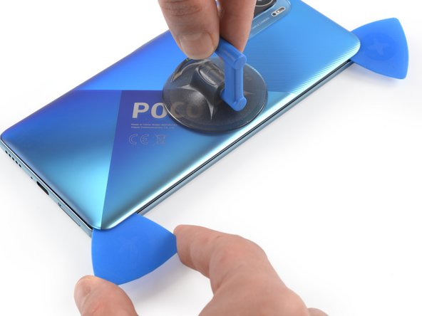

  2. Poco F3 Battery Replacement, Insert an opening pick: crwdns2935265:02crwdnd2935265:01crwdnd2935265:02crwdne2935265:0 Poco F3 Battery Replacement, Insert an opening pick: crwdns2935265:02crwdnd2935265:02crwdnd2935265:02crwdne2935265:0
    • Secure a suction handle to the right edge of the rear glass, as close to the edge as possible.
    • If the rear glass is cracked, the suction handle may not stick. Try lifting it with strong tape, or superglue the suction handle in place and allow it to cure so you can proceed.
    • Lift the rear glass with the suction handle to create a small gap between the rear glass and the frame.
    • In case you have trouble creating a gap, apply more heat to further soften the adhesive. Follow the iOpener instructions to avoid overheating.
    • Insert an opening pick into the gap you created.

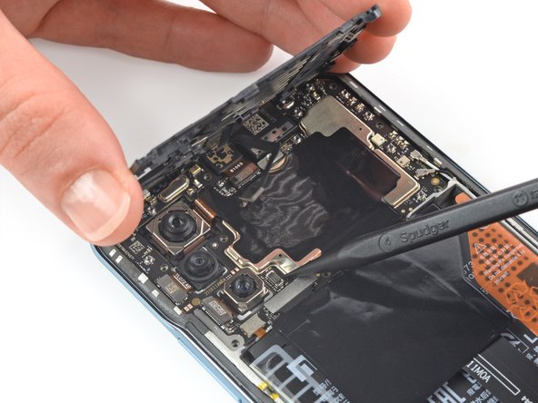

  11. Poco F3 Battery Replacement, Disconnect the motherboard cover: crwdns2935265:011crwdnd2935265:01crwdnd2935265:02crwdne2935265:0 Poco F3 Battery Replacement, Disconnect the motherboard cover: crwdns2935265:011crwdnd2935265:02crwdnd2935265:02crwdne2935265:0
    • Use your fingers to lift up the motherboard cover to access the connector on the motherboard.
    • Use a spudger to disconnect the motherboard cover by prying the connector straight up from its socket at the motherboard.
    • Remove the motherboard cover.

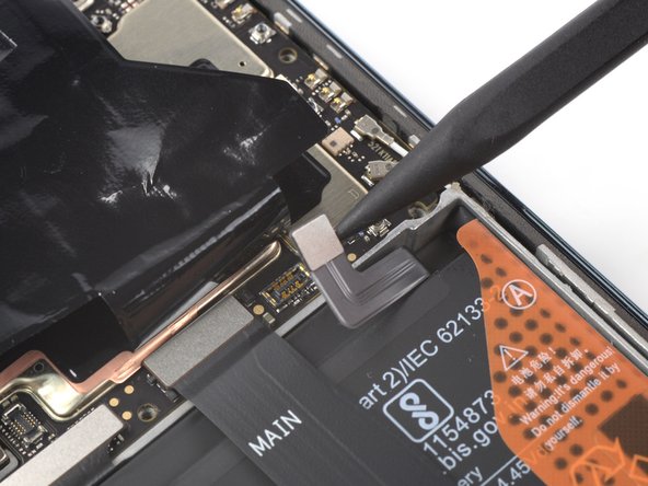

  12. Poco F3 Battery Replacement, Disconnect the battery: crwdns2935265:012crwdnd2935265:01crwdnd2935265:02crwdne2935265:0 Poco F3 Battery Replacement, Disconnect the battery: crwdns2935265:012crwdnd2935265:02crwdnd2935265:02crwdne2935265:0
    • The battery connector is covered by a graphite foil. Carefully fold it up or tape it to the top edge of the Poco F3 to access the battery connector.
    • Use a spudger to disconnect the battery by prying the connector straight up from its socket.

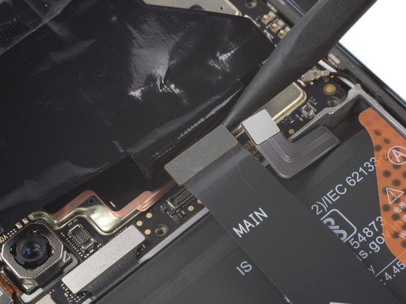

  13. Poco F3 Battery Replacement, Disconnect the interconnect cable: crwdns2935265:013crwdnd2935265:01crwdnd2935265:02crwdne2935265:0 Poco F3 Battery Replacement, Disconnect the interconnect cable: crwdns2935265:013crwdnd2935265:02crwdnd2935265:02crwdne2935265:0
    • Use a spudger to pry the interconnect cable straight up from its socket on the motherboard.
  14. Poco F3 Battery Replacement, Reposition the interconnect cable: crwdns2935265:014crwdnd2935265:01crwdnd2935265:03crwdne2935265:0 Poco F3 Battery Replacement, Reposition the interconnect cable: crwdns2935265:014crwdnd2935265:02crwdnd2935265:03crwdne2935265:0 Poco F3 Battery Replacement, Reposition the interconnect cable: crwdns2935265:014crwdnd2935265:03crwdnd2935265:03crwdne2935265:0
    • Reposition the interconnect cable toward the bottom of the phone and out of the way of the battery.
    • Take care not to crease the cable.
    • Reposition the graphite foil toward the bottom of the phone, which is covering the bottom left corner of the battery.
    • You can use a small piece of tape to temporarily stick the cable and the graphite foil to your working surface to avoid accidentally damaging it during the battery removal.

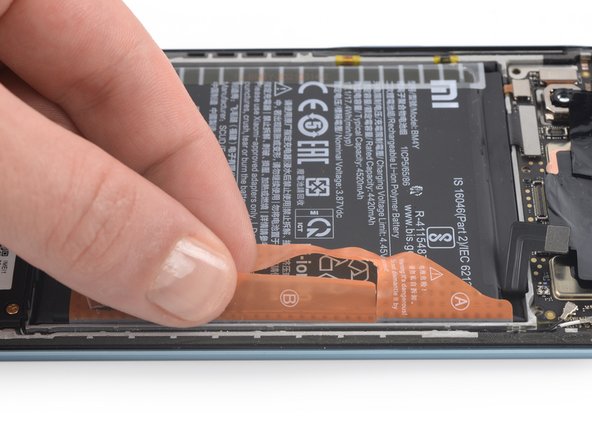

  15. Poco F3 Battery Replacement, Peel off the stickers: crwdns2935265:015crwdnd2935265:01crwdnd2935265:02crwdne2935265:0 Poco F3 Battery Replacement, Peel off the stickers: crwdns2935265:015crwdnd2935265:02crwdnd2935265:02crwdne2935265:0
    • Use your fingers to peel the two orange stickers labeled A and B off the battery.

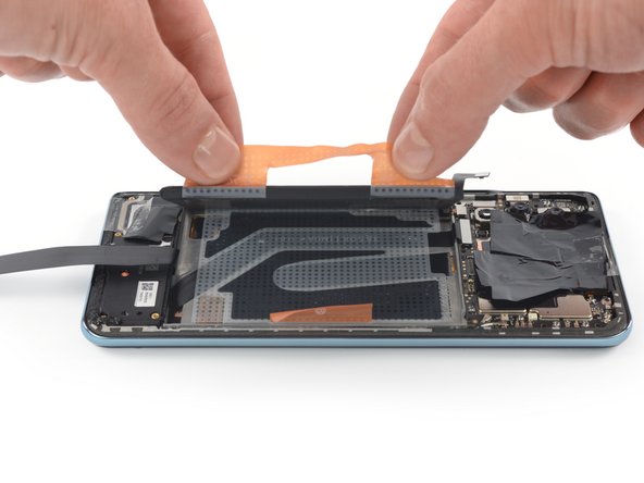

  16. Poco F3 Battery Replacement, Pull up the battery: crwdns2935265:016crwdnd2935265:01crwdnd2935265:03crwdne2935265:0 Poco F3 Battery Replacement, Pull up the battery: crwdns2935265:016crwdnd2935265:02crwdnd2935265:03crwdne2935265:0 Poco F3 Battery Replacement, Pull up the battery: crwdns2935265:016crwdnd2935265:03crwdnd2935265:03crwdne2935265:0
    • Grab both ends of the orange sticker labeled with the letter A.
    • Pull both ends of the orange sticker straight up to lift the battery out of its recess.
    • If you're having a hard time removing the battery, place a heated iOpener on the screen or use a heat gun to soften the adhesive beneath the battery. Apply the iOpener for at least two minutes.

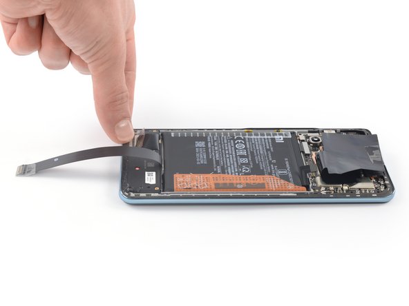

  17. Poco F3 Battery Replacement, Remove the battery: crwdns2935265:017crwdnd2935265:01crwdnd2935265:01crwdne2935265:0
    • Remove the battery.
    • Do not reuse the battery after it has been removed, as doing so is a potential safety hazard. Replace it with a new battery.
    • You can reuse the old adhesive tape if it's still sticky. However if you want to replace your screen you need to remove it and replace it with new custom cut adhesive tape.
