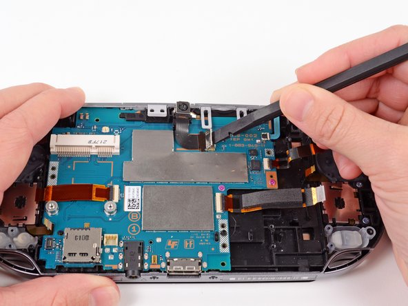

  42. PlayStation Vita Rear Camera Replacement: crwdns2935265:042crwdnd2935265:01crwdnd2935265:03crwdne2935265:0 PlayStation Vita Rear Camera Replacement: crwdns2935265:042crwdnd2935265:02crwdnd2935265:03crwdne2935265:0 PlayStation Vita Rear Camera Replacement: crwdns2935265:042crwdnd2935265:03crwdnd2935265:03crwdne2935265:0
    • Starting at the upper right hand corner, use a spudger to gently lift the motherboard out of the casing assembly.
    • The motherboard is still attached to the casing by a connector on the back of the motherboard. Do not pull the motherboard all the way out, or you may damage the connector.
  43. PlayStation Vita Rear Camera Replacement: crwdns2935265:043crwdnd2935265:01crwdnd2935265:03crwdne2935265:0 PlayStation Vita Rear Camera Replacement: crwdns2935265:043crwdnd2935265:02crwdnd2935265:03crwdne2935265:0 PlayStation Vita Rear Camera Replacement: crwdns2935265:043crwdnd2935265:03crwdnd2935265:03crwdne2935265:0
    • Lift the motherboard out and identify the OLED connector still attaching the motherboard to the casing.
    • Holding the Vita on its side, use a spudger to gently pry off the OLED connector from the motherboard.
    • Be sure to hold the motherboard while you release the connector as this will free the motherboard. If you are not holding the motherboard, it will fall.
  44. PlayStation Vita Rear Camera Replacement: crwdns2935265:044crwdnd2935265:01crwdnd2935265:01crwdne2935265:0
    • Completely separate the motherboard from the case. Set the case aside.
  45. PlayStation Vita Rear Camera Replacement: crwdns2935265:045crwdnd2935265:01crwdnd2935265:02crwdne2935265:0 PlayStation Vita Rear Camera Replacement: crwdns2935265:045crwdnd2935265:02crwdnd2935265:02crwdne2935265:0
    • Flip the motherboard over so that the rear camera is facing you on the right.
    • Release the rear camera flex cable socket by prying up on the tab with a spudger. Leave the socket open.
  46. PlayStation Vita Rear Camera Replacement: crwdns2935265:046crwdnd2935265:01crwdnd2935265:03crwdne2935265:0 PlayStation Vita Rear Camera Replacement: crwdns2935265:046crwdnd2935265:02crwdnd2935265:03crwdne2935265:0 PlayStation Vita Rear Camera Replacement: crwdns2935265:046crwdnd2935265:03crwdnd2935265:03crwdne2935265:0
    • Gently pull the rear camera out of the flex cable socket.
