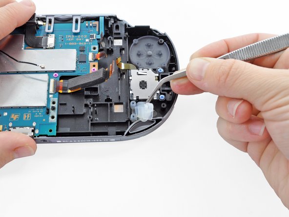

  20. PlayStation Vita PS Button Replacement, PS Button: crwdns2935265:020crwdnd2935265:01crwdnd2935265:03crwdne2935265:0 PlayStation Vita PS Button Replacement, PS Button: crwdns2935265:020crwdnd2935265:02crwdnd2935265:03crwdne2935265:0 PlayStation Vita PS Button Replacement, PS Button: crwdns2935265:020crwdnd2935265:03crwdnd2935265:03crwdne2935265:0
    • Using tweezers, peel up and remove the PS button.
