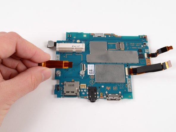

    • Using a spudger, release the tab on the ZIF connector located above the two screw posts where the wireless card once was.
  47. PlayStation Vita Motherboard Replacement: crwdns2935265:047crwdnd2935265:01crwdnd2935265:03crwdne2935265:0 PlayStation Vita Motherboard Replacement: crwdns2935265:047crwdnd2935265:02crwdnd2935265:03crwdne2935265:0 PlayStation Vita Motherboard Replacement: crwdns2935265:047crwdnd2935265:03crwdnd2935265:03crwdne2935265:0
    • Gently pull the flex cable out of the ZIF connector, and remove it.

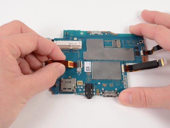

  48. PlayStation Vita Motherboard Replacement: crwdns2935265:048crwdnd2935265:01crwdnd2935265:02crwdne2935265:0 PlayStation Vita Motherboard Replacement: crwdns2935265:048crwdnd2935265:02crwdnd2935265:02crwdne2935265:0
    • Release the tab on the large ZIF connector on the right side of the motherboard by lifting the tab with a spudger.
  49. PlayStation Vita Motherboard Replacement: crwdns2935265:049crwdnd2935265:01crwdnd2935265:02crwdne2935265:0 PlayStation Vita Motherboard Replacement: crwdns2935265:049crwdnd2935265:02crwdnd2935265:02crwdne2935265:0

    • Using a spudger, release the small ZIF connector on the right side of the motherboard.
  51. PlayStation Vita Motherboard Replacement: crwdns2935265:051crwdnd2935265:01crwdnd2935265:03crwdne2935265:0 PlayStation Vita Motherboard Replacement: crwdns2935265:051crwdnd2935265:02crwdnd2935265:03crwdne2935265:0 PlayStation Vita Motherboard Replacement: crwdns2935265:051crwdnd2935265:03crwdnd2935265:03crwdne2935265:0
    • Gently pull the flex cable out of the small ZIF connector, and remove it.
