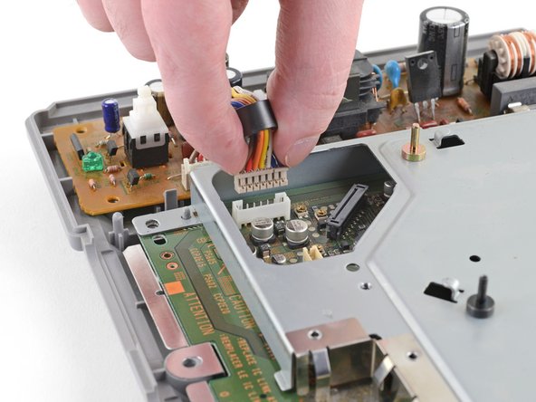

    1. PlayStation Motherboard Replacement, Remove the Optical Drive: crwdns2935265:07crwdnd2935265:01crwdnd2935265:02crwdne2935265:0 PlayStation Motherboard Replacement, Remove the Optical Drive: crwdns2935265:07crwdnd2935265:02crwdnd2935265:02crwdne2935265:0
      • Pull the optical drive power cable straight up and out of its socket on the motherboard to disconnect it.
    2. PlayStation Motherboard Replacement: crwdns2935265:08crwdnd2935265:01crwdnd2935265:03crwdne2935265:0 PlayStation Motherboard Replacement: crwdns2935265:08crwdnd2935265:02crwdnd2935265:03crwdne2935265:0 PlayStation Motherboard Replacement: crwdns2935265:08crwdnd2935265:03crwdnd2935265:03crwdne2935265:0
      • Use the flat end of a spudger to lift up and unlock one side of the data cable's connector on the motherboard. Repeat this step on the other side of the connector.
      • You'll hear a faint click noise when unlocking the connector. Make sure not to apply too much pressure when lifting up on the connector with the spudger, or else damage may result.
      • Gently pull the optical drive data cable straight up and out of its socket on the motherboard to disconnect it.

    1. PlayStation Motherboard Replacement, Unplug the Power Supply: crwdns2935265:010crwdnd2935265:01crwdnd2935265:02crwdne2935265:0 PlayStation Motherboard Replacement, Unplug the Power Supply: crwdns2935265:010crwdnd2935265:02crwdnd2935265:02crwdne2935265:0
      • Pull the power supply cable straight up and out of its socket on the motherboard to disconnect it.

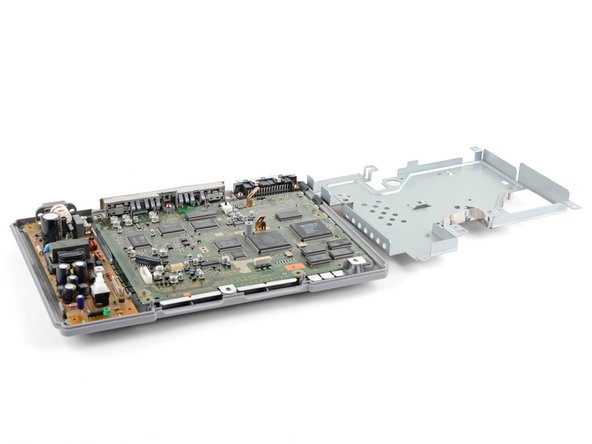

    2. PlayStation Motherboard Replacement, Remove the Motherboard's Metal Shield: crwdns2935265:011crwdnd2935265:01crwdnd2935265:01crwdne2935265:0
      • Remove the five 14 mm-long Phillips #1 screws from the motherboard's metal shield.
    3. PlayStation Motherboard Replacement: crwdns2935265:012crwdnd2935265:01crwdnd2935265:03crwdne2935265:0 PlayStation Motherboard Replacement: crwdns2935265:012crwdnd2935265:02crwdnd2935265:03crwdne2935265:0 PlayStation Motherboard Replacement: crwdns2935265:012crwdnd2935265:03crwdnd2935265:03crwdne2935265:0
      • From the left side, lift up the metal shield and rotate it about its right edge, opening it like a book.
      • There may be strips of tape holding the right side of the metal shield to the case, necessitating this kind of removal procedure. If there isn't tape, you can simply lift the shield straight up to remove it.

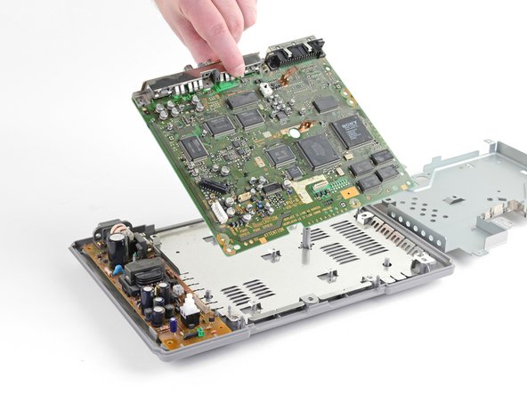

    4. PlayStation Motherboard Replacement, Remove the Motherboard: crwdns2935265:013crwdnd2935265:01crwdnd2935265:01crwdne2935265:0
      • Remove the three 14 mm-long Phillips #1 screws securing the motherboard to the bottom case.
    5. PlayStation Motherboard Replacement: crwdns2935265:014crwdnd2935265:01crwdnd2935265:02crwdne2935265:0 PlayStation Motherboard Replacement: crwdns2935265:014crwdnd2935265:02crwdnd2935265:02crwdne2935265:0
      • Lift the motherboard out of the bottom case.
