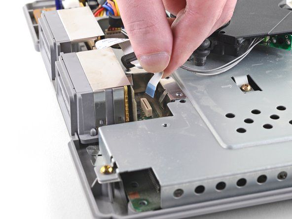

    1. PlayStation Controller Ports Replacement, Remove the Controller Ports: crwdns2935265:03crwdnd2935265:01crwdnd2935265:01crwdne2935265:0
      • Remove five Phillips #1 screws securing the metal shield to the controller ports:
      • Two 14 mm screws
      • Three 8 mm screws
    2. PlayStation Controller Ports Replacement: crwdns2935265:04crwdnd2935265:01crwdnd2935265:02crwdne2935265:0 PlayStation Controller Ports Replacement: crwdns2935265:04crwdnd2935265:02crwdnd2935265:02crwdne2935265:0
      • Lift the metal shield straight up to remove it.
    3. PlayStation Controller Ports Replacement: crwdns2935265:05crwdnd2935265:01crwdnd2935265:02crwdne2935265:0 PlayStation Controller Ports Replacement: crwdns2935265:05crwdnd2935265:02crwdnd2935265:02crwdne2935265:0
      • Pull the controller port's ribbon cable straight up and out of its socket on the motherboard to disconnect it.
    4. PlayStation Controller Ports Replacement: crwdns2935265:06crwdnd2935265:01crwdnd2935265:02crwdne2935265:0 PlayStation Controller Ports Replacement: crwdns2935265:06crwdnd2935265:02crwdnd2935265:02crwdne2935265:0
      • Lift the controller ports straight up and out of the bottom case.
