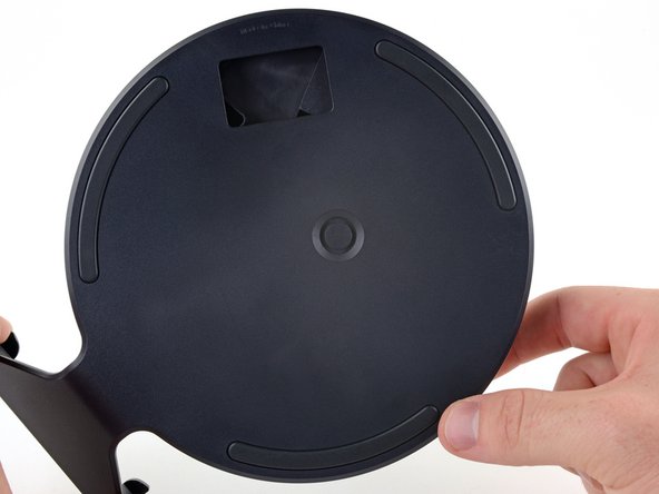

  1. PlayStation 5 (2021 revision) Motherboard Replacement, Remove the stand screw: crwdns2935265:01crwdnd2935265:01crwdnd2935265:01crwdne2935265:0
    • If your PlayStation 5 is in its vertical orientation, flip it upside down so the stand is facing up.
    • If your PlayStation 5 is in its horizontal orientation, skip to Step 6.
    • Work on a flat surface to prevent your PlayStation from falling over.
    • Use a coin or a flathead screwdriver to remove the 26.5 mm-long stand screw.

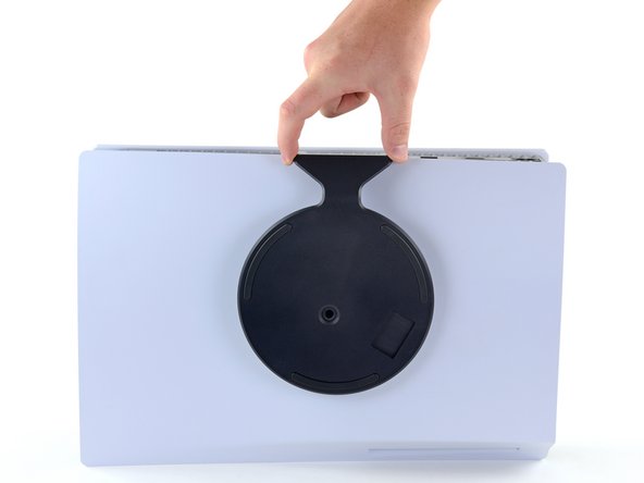

  2. PlayStation 5 (2021 revision) Motherboard Replacement, Remove the vertical stand: crwdns2935265:02crwdnd2935265:01crwdnd2935265:02crwdne2935265:0 PlayStation 5 (2021 revision) Motherboard Replacement, Remove the vertical stand: crwdns2935265:02crwdnd2935265:02crwdnd2935265:02crwdne2935265:0
    • Lift straight up to remove the stand.

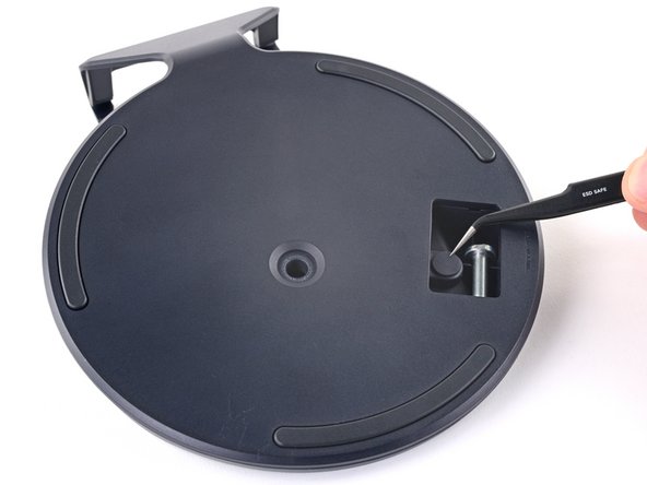

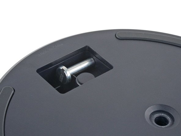

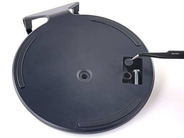

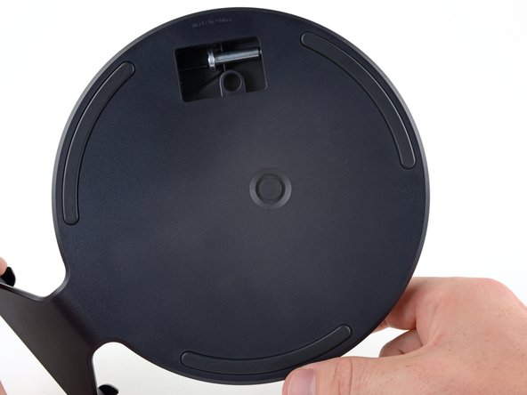

  3. PlayStation 5 (2021 revision) Motherboard Replacement, Store the stand screw: crwdns2935265:03crwdnd2935265:01crwdnd2935265:02crwdne2935265:0 PlayStation 5 (2021 revision) Motherboard Replacement, Store the stand screw: crwdns2935265:03crwdnd2935265:02crwdnd2935265:02crwdne2935265:0
    • Insert the screw into the cubby on the bottom of the stand.

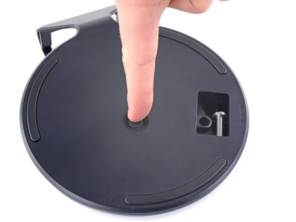

  4. PlayStation 5 (2021 revision) Motherboard Replacement, Cap the screw hole: crwdns2935265:04crwdnd2935265:01crwdnd2935265:03crwdne2935265:0 PlayStation 5 (2021 revision) Motherboard Replacement, Cap the screw hole: crwdns2935265:04crwdnd2935265:02crwdnd2935265:03crwdne2935265:0 PlayStation 5 (2021 revision) Motherboard Replacement, Cap the screw hole: crwdns2935265:04crwdnd2935265:03crwdnd2935265:03crwdne2935265:0
    • Use a pair of tweezers or your fingernail to remove the cap from the cubby.
    • Use your finger to press the cap into the screw hole.

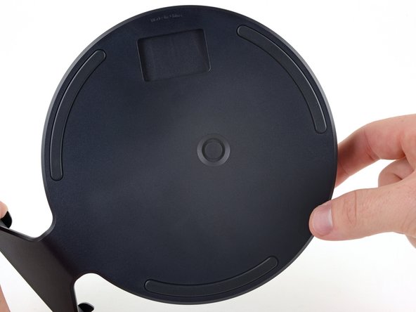

  5. PlayStation 5 (2021 revision) Motherboard Replacement, Close the cubby: crwdns2935265:05crwdnd2935265:01crwdnd2935265:03crwdne2935265:0 PlayStation 5 (2021 revision) Motherboard Replacement, Close the cubby: crwdns2935265:05crwdnd2935265:02crwdnd2935265:03crwdne2935265:0 PlayStation 5 (2021 revision) Motherboard Replacement, Close the cubby: crwdns2935265:05crwdnd2935265:03crwdnd2935265:03crwdne2935265:0
    • Twist the stand counterclockwise to close the cubby.

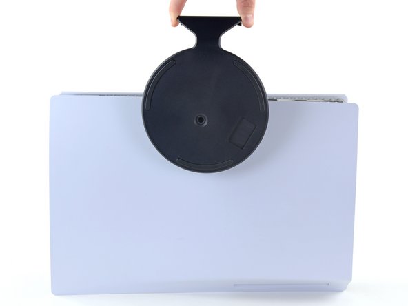

  6. PlayStation 5 (2021 revision) Motherboard Replacement, Remove the horizontal stand: crwdns2935265:06crwdnd2935265:01crwdnd2935265:02crwdne2935265:0 PlayStation 5 (2021 revision) Motherboard Replacement, Remove the horizontal stand: crwdns2935265:06crwdnd2935265:02crwdnd2935265:02crwdne2935265:0
    • If your PlayStation 5 is in its horizontal orientation, rest it on its face with the charging port facing up.
    • Lift the stand straight up to remove it.
    • Flip the device over so that the USB and ethernet ports are on the left side from your perspective.
    • Lift up the corner of the faceplate to unclip it from the case.
