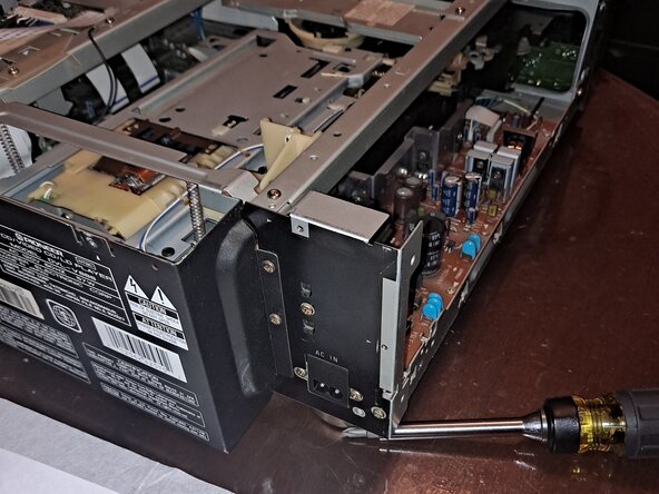

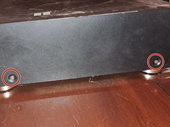

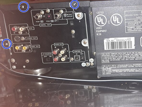

    • Find each screw located on the player, there should be 2 screws on both the left and right side. There will also be 6 screws on the back.
    • Acquire your philips head screwdriver and carefully remove each screw carefully.
    • The 2 Screws on the left and right side are Black 5.1mm Philips #2 screws.
    • The 6 screws on the back are Brass 5.1mm Philips #2 screws.
  3. Pioneer DVL-V888 Laserdisc Player Rubber Belt Replacement: crwdns2935265:03crwdnd2935265:01crwdnd2935265:03crwdne2935265:0 Pioneer DVL-V888 Laserdisc Player Rubber Belt Replacement: crwdns2935265:03crwdnd2935265:02crwdnd2935265:03crwdne2935265:0 Pioneer DVL-V888 Laserdisc Player Rubber Belt Replacement: crwdns2935265:03crwdnd2935265:03crwdnd2935265:03crwdne2935265:0

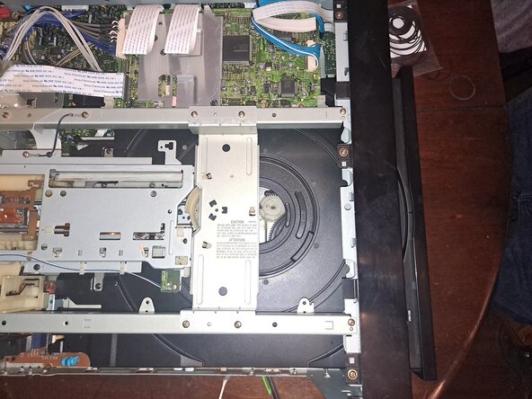

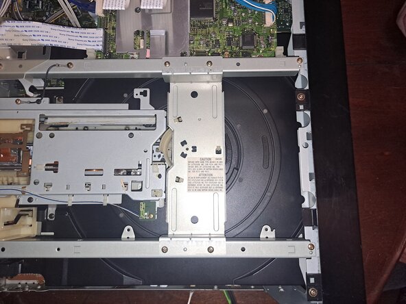

    • Once all of the screws are removed, slide the top off of the laserdisc player so that the whole frame is exposed.

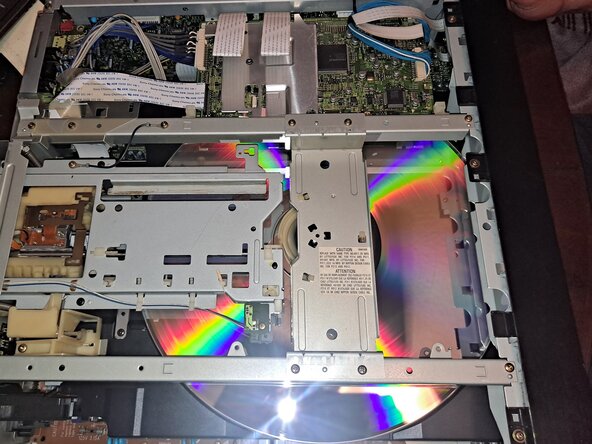

  4. Pioneer DVL-V888 Laserdisc Player Rubber Belt Replacement: crwdns2935265:04crwdnd2935265:01crwdnd2935265:02crwdne2935265:0 Pioneer DVL-V888 Laserdisc Player Rubber Belt Replacement: crwdns2935265:04crwdnd2935265:02crwdnd2935265:02crwdne2935265:0

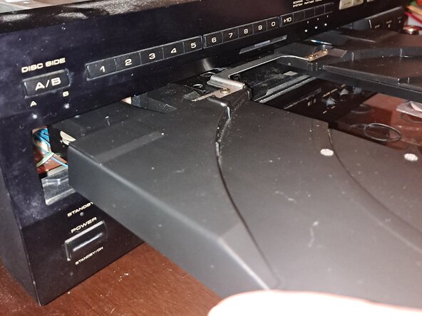

    • Plug the device back in and click the power button to confirm that the conveyor belt for the disc player works.
    • If the disc tray slides out, continue to the next step.
  5. Pioneer DVL-V888 Laserdisc Player Rubber Belt Replacement: crwdns2935265:05crwdnd2935265:01crwdnd2935265:02crwdne2935265:0 Pioneer DVL-V888 Laserdisc Player Rubber Belt Replacement: crwdns2935265:05crwdnd2935265:02crwdnd2935265:02crwdne2935265:0

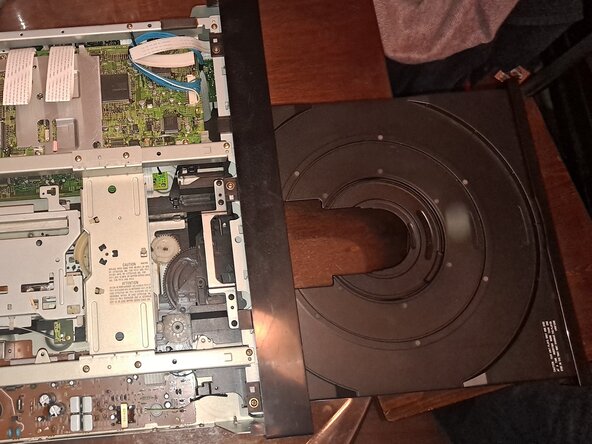

    • Unplug the power source again, this time while the disc tray is out.
    • This is very important as if the device is plugged in during later steps, the tray may automatically retreat back into the device which may damage either the player, you, or both.

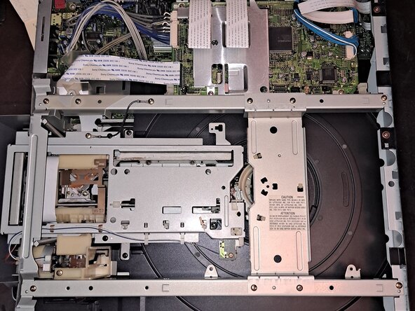

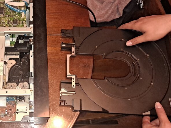

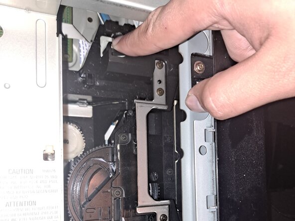

  6. Pioneer DVL-V888 Laserdisc Player Rubber Belt Replacement: crwdns2935265:06crwdnd2935265:01crwdnd2935265:03crwdne2935265:0 Pioneer DVL-V888 Laserdisc Player Rubber Belt Replacement: crwdns2935265:06crwdnd2935265:02crwdnd2935265:03crwdne2935265:0 Pioneer DVL-V888 Laserdisc Player Rubber Belt Replacement: crwdns2935265:06crwdnd2935265:03crwdnd2935265:03crwdne2935265:0

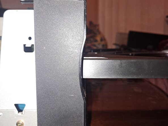

    • Loosen the two clips shown in the picture to release the lock holding the disc tray in place.
    • Slide the disc tray out of the laserdisc player horizontally ensuring no damage to the other parts.

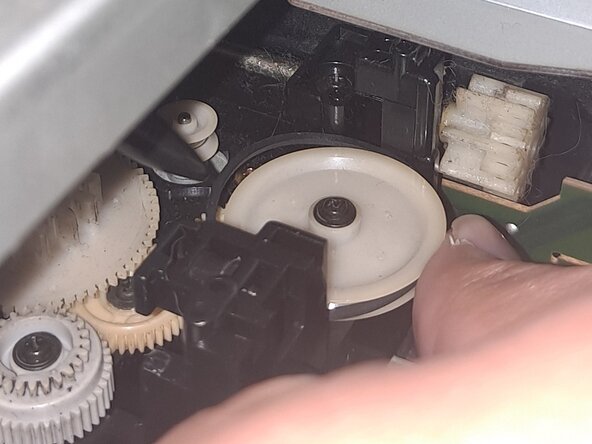

  7. Pioneer DVL-V888 Laserdisc Player Rubber Belt Replacement: crwdns2935265:07crwdnd2935265:01crwdnd2935265:03crwdne2935265:0 Pioneer DVL-V888 Laserdisc Player Rubber Belt Replacement: crwdns2935265:07crwdnd2935265:02crwdnd2935265:03crwdne2935265:0 Pioneer DVL-V888 Laserdisc Player Rubber Belt Replacement: crwdns2935265:07crwdnd2935265:03crwdnd2935265:03crwdne2935265:0

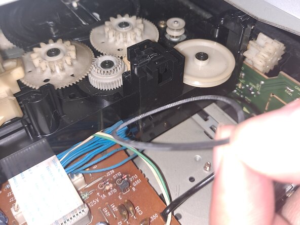

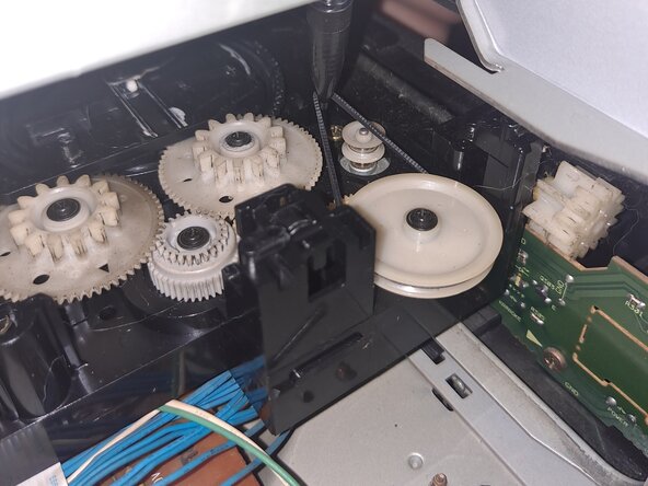

    • Locate 3 gears and a wheel spinner within the laserdisc player and focus on the wheel.
    • Remove the rubber band from the wheel carefully (To the right of the gears).
  8. Pioneer DVL-V888 Laserdisc Player Rubber Belt Replacement: crwdns2935265:08crwdnd2935265:01crwdnd2935265:02crwdne2935265:0 Pioneer DVL-V888 Laserdisc Player Rubber Belt Replacement: crwdns2935265:08crwdnd2935265:02crwdnd2935265:02crwdne2935265:0

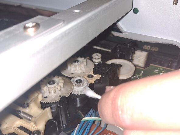

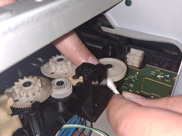

    • Prepare the rubber belt for replacement as well as Q-tips and isopropyl alcohol for cleaning.
    • Cleaning is completely optional, however it will improve the longetivity of the new rubber belt you will be placing in the laserdisc player).
  9. Pioneer DVL-V888 Laserdisc Player Rubber Belt Replacement: crwdns2935265:09crwdnd2935265:01crwdnd2935265:03crwdne2935265:0 Pioneer DVL-V888 Laserdisc Player Rubber Belt Replacement: crwdns2935265:09crwdnd2935265:02crwdnd2935265:03crwdne2935265:0 Pioneer DVL-V888 Laserdisc Player Rubber Belt Replacement: crwdns2935265:09crwdnd2935265:03crwdnd2935265:03crwdne2935265:0
    • The following step is entirely optional.
    • Dip a Q-tip into the Isopropyl alcohol and use it to clean the gears and wheels.
  10. Pioneer DVL-V888 Laserdisc Player Rubber Belt Replacement: crwdns2935265:010crwdnd2935265:01crwdnd2935265:02crwdne2935265:0 Pioneer DVL-V888 Laserdisc Player Rubber Belt Replacement: crwdns2935265:010crwdnd2935265:02crwdnd2935265:02crwdne2935265:0
    • Wrap the rubber belt around the larger wheel and make sure it is stable.

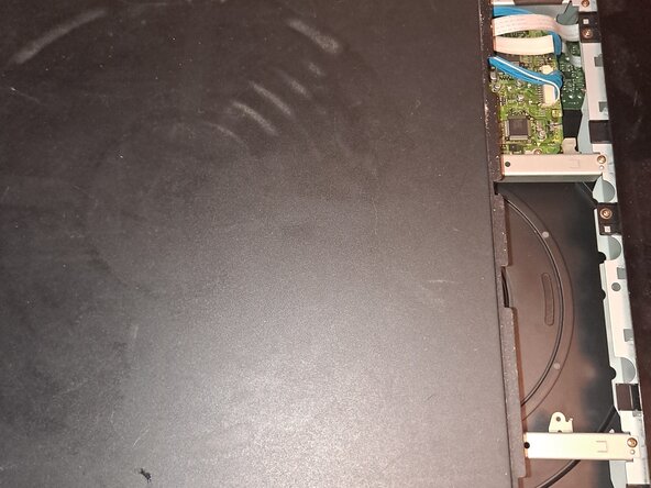

  11. Pioneer DVL-V888 Laserdisc Player Rubber Belt Replacement: crwdns2935265:011crwdnd2935265:01crwdnd2935265:03crwdne2935265:0 Pioneer DVL-V888 Laserdisc Player Rubber Belt Replacement: crwdns2935265:011crwdnd2935265:02crwdnd2935265:03crwdne2935265:0 Pioneer DVL-V888 Laserdisc Player Rubber Belt Replacement: crwdns2935265:011crwdnd2935265:03crwdnd2935265:03crwdne2935265:0
    • Hold the disc tray in a stable position horizontally and ensure it that it is lined up with the tray slot.
    • For the next step, it is critical that the tray is lined up when we will slide it in as if the tray is misaligned, the tray may get stuck and can cause damage to the laserdisc player. It will also make the process of fixing it much longer.
  12. Pioneer DVL-V888 Laserdisc Player Rubber Belt Replacement: crwdns2935265:012crwdnd2935265:01crwdnd2935265:03crwdne2935265:0 Pioneer DVL-V888 Laserdisc Player Rubber Belt Replacement: crwdns2935265:012crwdnd2935265:02crwdnd2935265:03crwdne2935265:0 Pioneer DVL-V888 Laserdisc Player Rubber Belt Replacement: crwdns2935265:012crwdnd2935265:03crwdnd2935265:03crwdne2935265:0
    • Slide the disc tray back into the device ensuring it was aligned before placing inside.

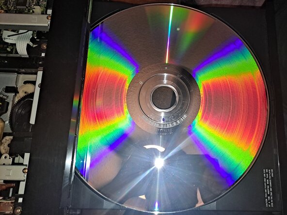

  13. Pioneer DVL-V888 Laserdisc Player Rubber Belt Replacement: crwdns2935265:013crwdnd2935265:01crwdnd2935265:03crwdne2935265:0 Pioneer DVL-V888 Laserdisc Player Rubber Belt Replacement: crwdns2935265:013crwdnd2935265:02crwdnd2935265:03crwdne2935265:0 Pioneer DVL-V888 Laserdisc Player Rubber Belt Replacement: crwdns2935265:013crwdnd2935265:03crwdnd2935265:03crwdne2935265:0
    • Plug the device back in and insert a laserdisc to test if the device is functioning.
  14. Pioneer DVL-V888 Laserdisc Player Rubber Belt Replacement: crwdns2935265:014crwdnd2935265:01crwdnd2935265:01crwdne2935265:0
    • If the device is functioning correctly, you may now reassemble the device placing the metal cover over the top.
    • Re-insert the screws and tighten them so that they are not loose.
    • The brass screws are to be reinserted into the back while the black screws are to be inserted into the sides
    • Enjoy your finished work, Well Done!
