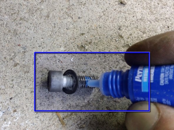

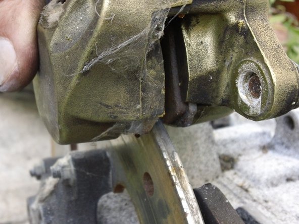

    • Loosen the two 6mm Allen bolts securing the rear caliper.
    • Apply blue Locktite or a similar product to these bolts upon reassembly to prevent them from rattling loose.
    • Lift the caliper up and free of the brake rotor.
    • Take care not to damage the brake line when moving the caliper. Do not let the caliper just hang from the brake line.

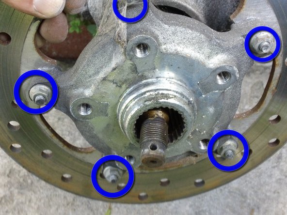

    • There is a spacer between the rear wheel and hub. It is not pressed on and should slide off easily.
    • The rear hub with rotor attached should now slide freely off of the rear axle.
    • Remove the five 10mm nuts, then the five 4mm Allen bolts they were locking into place to remove the rear brake rotor for replacement.
    • Apply Loctite or a similar product to the rotor hardware before reinstalling.
