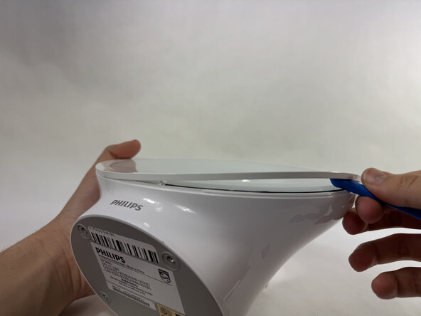

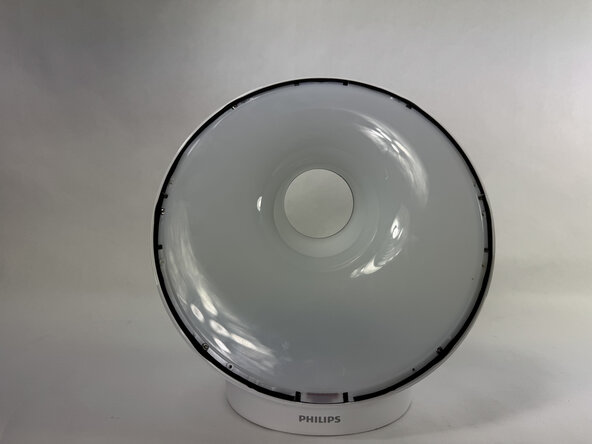

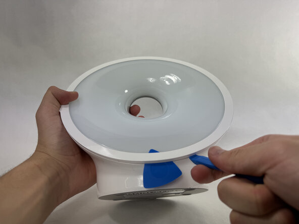

    • Use an opening pick to pry underneath the plastic covering the edges of the screen.
    • Place an opening tool in the space made between the screen and this plastic piece and pry up, working around the length of this circular piece to significantly loosen it.
  10. Philips Somneo Speaker Replacement: crwdns2935265:010crwdnd2935265:01crwdnd2935265:02crwdne2935265:0 Philips Somneo Speaker Replacement: crwdns2935265:010crwdnd2935265:02crwdnd2935265:02crwdne2935265:0
    • The panel should be loosened significantly enough to be pulled off the main body, revealing the edges of the screen.

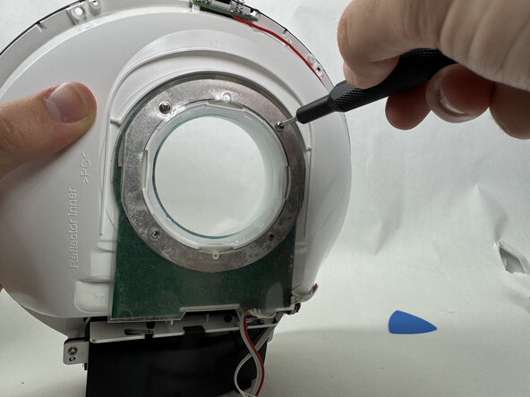

    • Remove the two 13 mm Phillips #0 screws on the bottom edges of the screen.
    • Remove the 9 mm Phillips #0 screws on the upper edge of the screen.

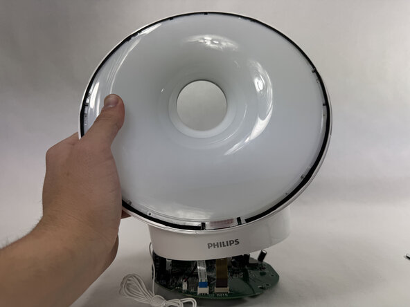

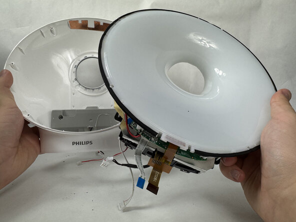

    • Remove the display assembly.

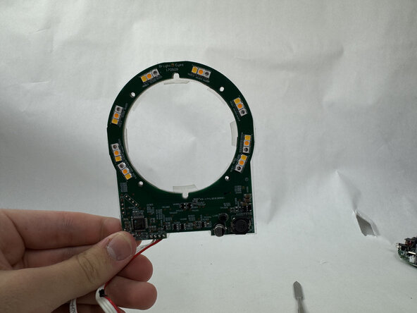

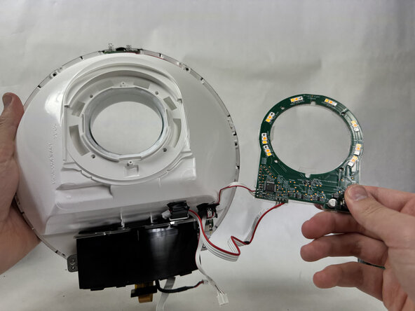

    • On the back of the screen, remove the four 9 mm Phillips #00 screws, disconnecting the LED assembly.
  14. Philips Somneo Speaker Replacement: crwdns2935265:014crwdnd2935265:01crwdnd2935265:03crwdne2935265:0 Philips Somneo Speaker Replacement: crwdns2935265:014crwdnd2935265:02crwdnd2935265:03crwdne2935265:0 Philips Somneo Speaker Replacement: crwdns2935265:014crwdnd2935265:03crwdnd2935265:03crwdne2935265:0

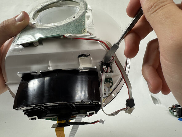

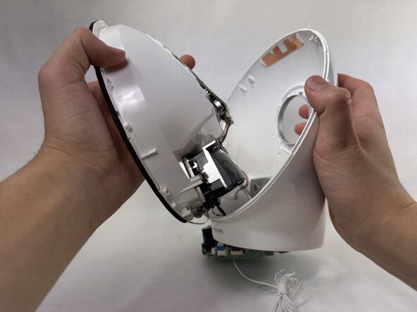

    • Two cables connected to the LED were once connected to the motherboard, but are still attached to the body. They are threaded through black ovals connected to the body by a hard black adhesive.
    • Using a metal spudger, scrape underneath this adhesive and pry up, freeing the cable from the body. Repeat this for the other cable to free the LED.
  15. Philips Somneo Speaker Replacement, Speaker: crwdns2935265:015crwdnd2935265:01crwdnd2935265:01crwdne2935265:0
    • The two components should look something like this.

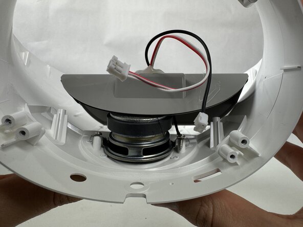

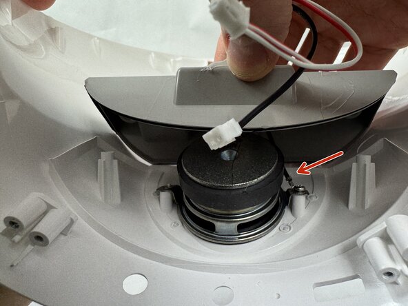

    • Use a screwdriver to remove the two screws marked.
    • Keep in mind the speaker hub will still not be able to be removed due to the wires running through it. These wires are directly attached to the speaker. If you are replacing the speaker, it is important that these are removed from the hub to allow for the replacement speaker to be introduced.
  17. Philips Somneo Speaker Replacement: crwdns2935265:017crwdnd2935265:01crwdnd2935265:03crwdne2935265:0 Philips Somneo Speaker Replacement: crwdns2935265:017crwdnd2935265:02crwdnd2935265:03crwdne2935265:0 Philips Somneo Speaker Replacement: crwdns2935265:017crwdnd2935265:03crwdnd2935265:03crwdne2935265:0
    • Remove the 9 mm screws marked.
    • Be careful with the screw located on the right. It is important when replacing the speaker that screw is inserted through the metal clip attached to the speaker as shown with an arrow.
  18. Philips Somneo Speaker Replacement: crwdns2935265:018crwdnd2935265:01crwdnd2935265:01crwdne2935265:0
    • Remove the speaker.
