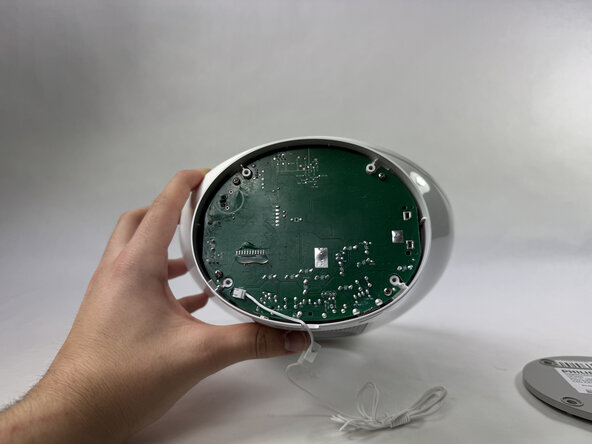

    • Remove the four silicone feet on the bottom plate.
    • Remove the following Phillips screws from the bottom plate:
    • Two 9 mm screws
    • Two 13 mm screws
  2. Philips Somneo Motherboard Replacement: crwdns2935265:02crwdnd2935265:01crwdnd2935265:02crwdne2935265:0 Philips Somneo Motherboard Replacement: crwdns2935265:02crwdnd2935265:02crwdnd2935265:02crwdne2935265:0
    • Remove the bottom plate from the device.

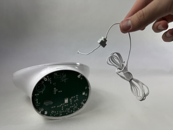

  3. Philips Somneo Motherboard Replacement: crwdns2935265:03crwdnd2935265:01crwdnd2935265:02crwdne2935265:0 Philips Somneo Motherboard Replacement: crwdns2935265:03crwdnd2935265:02crwdnd2935265:02crwdne2935265:0
    • Disconnect the antenna connector by pulling it directly out of its port.
    • Remove the antenna.

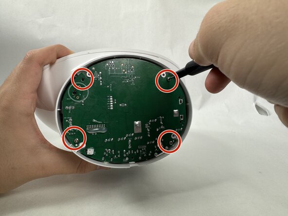

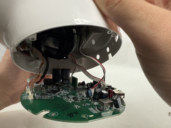

    • Remove the four 9 mm Phillips screws securing the motherboard.

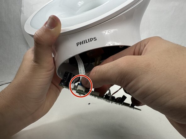

  5. Philips Somneo Motherboard Replacement: crwdns2935265:05crwdnd2935265:01crwdnd2935265:02crwdne2935265:0 Philips Somneo Motherboard Replacement: crwdns2935265:05crwdnd2935265:02crwdnd2935265:02crwdne2935265:0
    • Gently pull the motherboard down until the cables are visible.
    • Take care not to strain the connected cables.

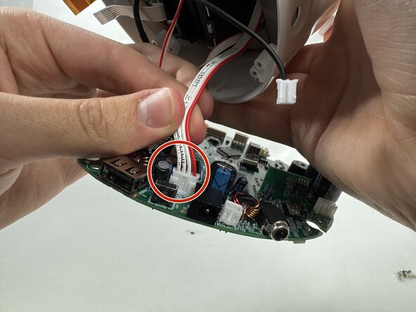

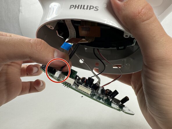

  6. Philips Somneo Motherboard Replacement: crwdns2935265:06crwdnd2935265:01crwdnd2935265:03crwdne2935265:0 Philips Somneo Motherboard Replacement: crwdns2935265:06crwdnd2935265:02crwdnd2935265:03crwdne2935265:0 Philips Somneo Motherboard Replacement: crwdns2935265:06crwdnd2935265:03crwdnd2935265:03crwdne2935265:0
    • Remove each cord by gently disconnecting each connector with your hand.

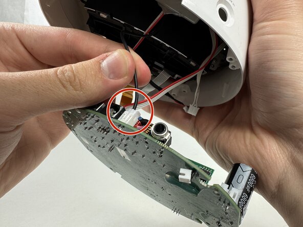

  7. Philips Somneo Motherboard Replacement: crwdns2935265:07crwdnd2935265:01crwdnd2935265:03crwdne2935265:0 Philips Somneo Motherboard Replacement: crwdns2935265:07crwdnd2935265:02crwdnd2935265:03crwdne2935265:0 Philips Somneo Motherboard Replacement: crwdns2935265:07crwdnd2935265:03crwdnd2935265:03crwdne2935265:0
    • Continue gently removing each cord with you hand.
  8. Philips Somneo Motherboard Replacement: crwdns2935265:08crwdnd2935265:01crwdnd2935265:02crwdne2935265:0 Philips Somneo Motherboard Replacement: crwdns2935265:08crwdnd2935265:02crwdnd2935265:02crwdne2935265:0

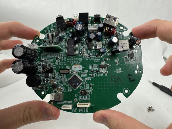

    • Finish gently removing the final cord attached to the motherboard to successfully remove the motherboard.
