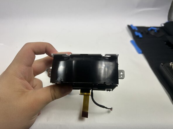

  15. Philips Somneo LCD Assembly Replacement, LCD Assembly: crwdns2935265:015crwdnd2935265:01crwdnd2935265:01crwdne2935265:0
    • Remove the two 13 mm Phillips screws securing the LCD assembly.
  16. Philips Somneo LCD Assembly Replacement: crwdns2935265:016crwdnd2935265:01crwdnd2935265:02crwdne2935265:0 Philips Somneo LCD Assembly Replacement: crwdns2935265:016crwdnd2935265:02crwdnd2935265:02crwdne2935265:0
    • Remove the LCD assembly.
