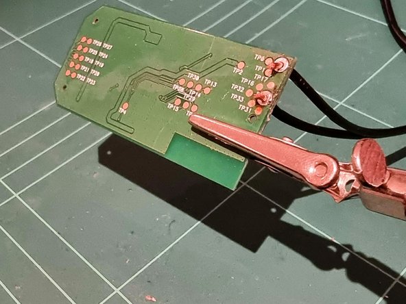

    • Lift the circuit board out of the control box
    • Using your Soldering Skills, desolder the red and black cables from the circuit board.

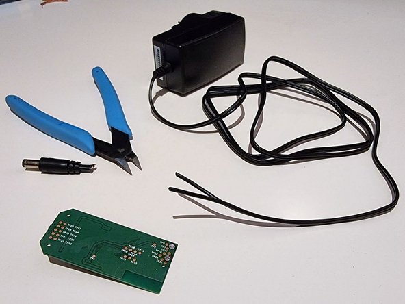

    • Purchase a reputable AC Adapter rated at exactly 24V and at least 0.83A as per the specifications written on the original adapter. For example, the Mean Well GE24I24-P1J. As this is a universal adapter, you will also need to purchase the appropriate Mean Well AC Plug for your region.

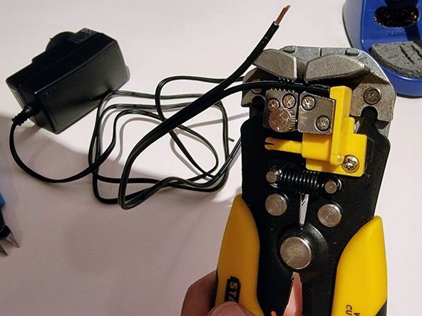

    • Using safety glasses and a wire cutter, cut the barrel connector off the end of the new AC Adapter.
    • Using a wire stripper, expose 1cm of copper on the ends of the positive and negative wires.

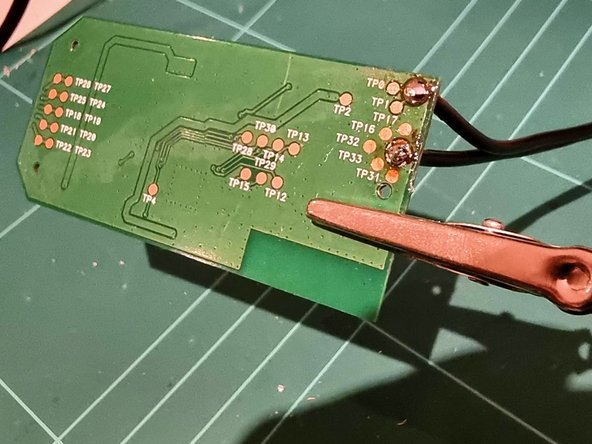

  4. Philips Hue LightStrip Plus AC power adapter Replacement, Solder new power cable to circuit board: crwdns2935265:04crwdnd2935265:01crwdnd2935265:03crwdne2935265:0 Philips Hue LightStrip Plus AC power adapter Replacement, Solder new power cable to circuit board: crwdns2935265:04crwdnd2935265:02crwdnd2935265:03crwdne2935265:0 Philips Hue LightStrip Plus AC power adapter Replacement, Solder new power cable to circuit board: crwdns2935265:04crwdnd2935265:03crwdnd2935265:03crwdne2935265:0
    • Insert the positive wire, differentiated with faint dashes, into the hole marked VBUS and solder it in place.
    • Insert the negative wire, into the hole marked GND and solder it in place.
