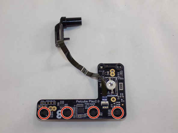

  10. Petcube Play 2 Microphone Replacement: crwdns2935265:010crwdnd2935265:01crwdnd2935265:02crwdne2935265:0 Petcube Play 2 Microphone Replacement: crwdns2935265:010crwdnd2935265:02crwdnd2935265:02crwdne2935265:0
    • Detach the PCB with the microphones from the plastic.
    • Using a soldering iron, desolder the microphones from the PCB.
    • Be careful! The soldering iron becomes hot! Avoid touching the device for too long, as this may damage the components.
    • To Avoid burning yourself or damaging the device, follow the IFixit soldering instructions
