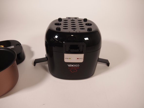

    • Remove the power cord and find a clean flat surface to work at.
  2. Perfect Cooker RC301M Disassembly: crwdns2935265:02crwdnd2935265:01crwdnd2935265:03crwdne2935265:0 Perfect Cooker RC301M Disassembly: crwdns2935265:02crwdnd2935265:02crwdnd2935265:03crwdne2935265:0 Perfect Cooker RC301M Disassembly: crwdns2935265:02crwdnd2935265:03crwdnd2935265:03crwdne2935265:0
    • Remove the lid by unhinging the side tabs.
    • Remove the inner pot and any other contents.

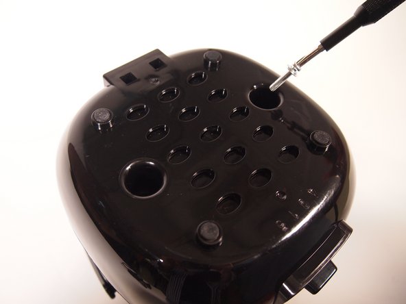

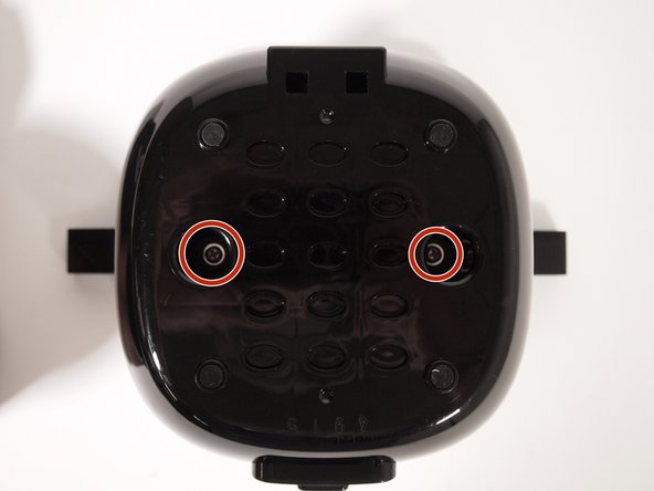

    • Flip the device over and look for the two screws recessed underneath the device.
  4. Perfect Cooker RC301M Disassembly: crwdns2935265:04crwdnd2935265:01crwdnd2935265:03crwdne2935265:0 Perfect Cooker RC301M Disassembly: crwdns2935265:04crwdnd2935265:02crwdnd2935265:03crwdne2935265:0 Perfect Cooker RC301M Disassembly: crwdns2935265:04crwdnd2935265:03crwdnd2935265:03crwdne2935265:0

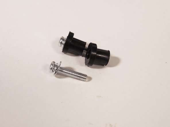

    • Using a Phillips #2 screwdriver, remove the two 32.8 mm screws.

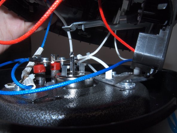

    • Carefully lift up the bottom to reveal the wires and mechanism.
    • Make sure not to pull it up too much as it is still connected to the device body with the center metal mechanism.

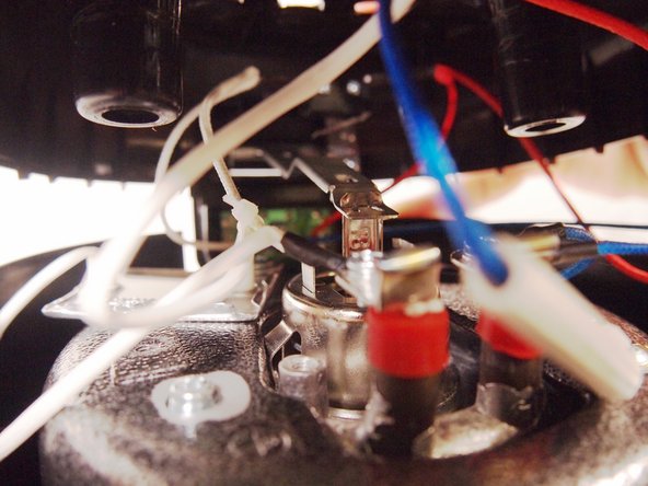

  6. Perfect Cooker RC301M Disassembly: crwdns2935265:06crwdnd2935265:01crwdnd2935265:01crwdne2935265:0
    • The center mechanism is directly in the center of the device and connects the switch to the middle
    • This part of the device raises and lowers the burner to change from the cook to warm function.
    • The two parts of the mechanism are connected by a simple metal “T-shaped” tab.

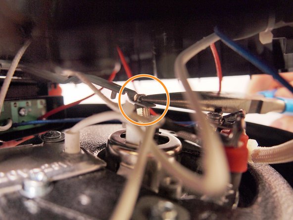

  7. Perfect Cooker RC301M Disassembly: crwdns2935265:07crwdnd2935265:01crwdnd2935265:03crwdne2935265:0 Perfect Cooker RC301M Disassembly: crwdns2935265:07crwdnd2935265:02crwdnd2935265:03crwdne2935265:0 Perfect Cooker RC301M Disassembly: crwdns2935265:07crwdnd2935265:03crwdnd2935265:03crwdne2935265:0
    • Disconnect the two metal arms.
    • It can be seen that the metal tab must be bent into a “U-shape” in order to fit through the other arm of the mechanism.
    • Take the small chain nose pliers and bend each side of the “T-shaped” tab inwards.
    • Use trial and error to bend the tabs until they are able to fit through the “U-shape” cut out in the other arm.
