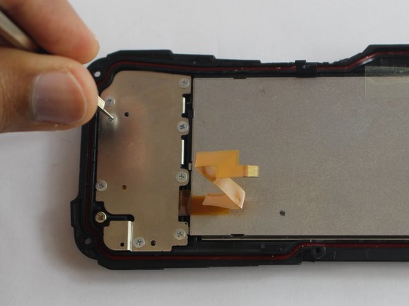

  7. Pentax Optio WG-2 Menu Buttons Replacement, Menu Buttons: crwdns2935265:07crwdnd2935265:01crwdnd2935265:02crwdne2935265:0 Pentax Optio WG-2 Menu Buttons Replacement, Menu Buttons: crwdns2935265:07crwdnd2935265:02crwdnd2935265:02crwdne2935265:0
    • Remove the eight JS#000 screws using a screwdriver and lift panel up.
    • This screw does not need to be removed.
  8. Pentax Optio WG-2 Menu Buttons Replacement: crwdns2935265:08crwdnd2935265:01crwdnd2935265:01crwdne2935265:0
    • Once panel is removed the button 'sheet' can be removed.
