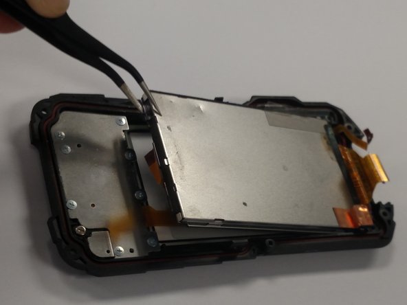

  7. Pentax Optio WG-2 LCD Screen Replacement, LCD Screen: crwdns2935265:07crwdnd2935265:01crwdnd2935265:02crwdne2935265:0 Pentax Optio WG-2 LCD Screen Replacement, LCD Screen: crwdns2935265:07crwdnd2935265:02crwdnd2935265:02crwdne2935265:0
    • Carefully remove the clear tape covering the screws and the ribbon cable.
    • Be careful not to tear the ribbon cable when removing the tape.
    • We want to remove the larger silver panel (right). The best way to do this is to slightly bend the cover backwards and use the tweezers to grab a corner and slowly lift the screen up and out.

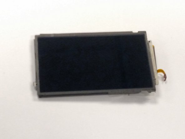

  8. Pentax Optio WG-2 LCD Screen Replacement: crwdns2935265:08crwdnd2935265:01crwdnd2935265:02crwdne2935265:0 Pentax Optio WG-2 LCD Screen Replacement: crwdns2935265:08crwdnd2935265:02crwdnd2935265:02crwdne2935265:0
    • Once the screen is removed you should have two pieces as seen in the picture.
    • The screen is the silver rectangle in the top of the picture or the component seen in picture two.
