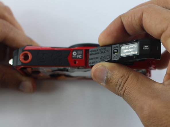

  7. Pentax Optio WG-2 Battery Compartment Door Replacement, Battery Compartment Door: crwdns2935265:07crwdnd2935265:01crwdnd2935265:03crwdne2935265:0 Pentax Optio WG-2 Battery Compartment Door Replacement, Battery Compartment Door: crwdns2935265:07crwdnd2935265:02crwdnd2935265:03crwdne2935265:0 Pentax Optio WG-2 Battery Compartment Door Replacement, Battery Compartment Door: crwdns2935265:07crwdnd2935265:03crwdnd2935265:03crwdne2935265:0
    • Lift the cover as you normally would if replacing battery.
    • Holding the camera with the lens facing away from you and the battery slot upward slide the cover towards the back of the camera.
    • There is a pin (3/4 of an inch long) that attaches the cover to the camera and it will come loose when the cover is removed.
