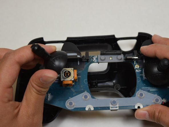

  3. Parrot FLYPAD Joystick Replacement: crwdns2935265:03crwdnd2935265:01crwdnd2935265:02crwdne2935265:0 Parrot FLYPAD Joystick Replacement: crwdns2935265:03crwdnd2935265:02crwdnd2935265:02crwdne2935265:0
    • Pop the joysticks out by pulling gently.
  4. Parrot FLYPAD Joystick Replacement: crwdns2935265:04crwdnd2935265:01crwdnd2935265:01crwdne2935265:0
    • Unscrew and replace joystick caps for a more comfortable grip.
