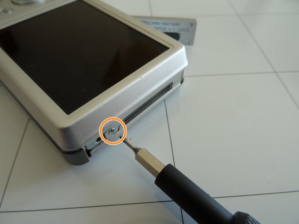

    • Remove the two 4.6 mm # 000 Phillips screws from the bottom near the tripod thread

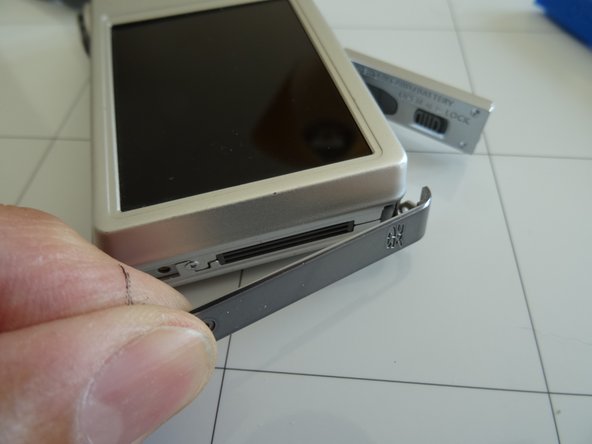

    • Use a spudger or plastic opener to remove the rear cover. Start next to the USB cover and slide the tool along the camera. Lift the rear housing cover off.
    • In the second picture you see the camera with the back cover removed.

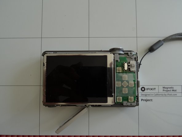

    • Carefully lift the keyboard board vertically upwards with your fingers.
    • The keyboard is still connected and connection is on the back of the board. Just pull it vertically upwards.
  8. Panasonic camera DMC FS 16 CCD cleaning: crwdns2935265:08crwdnd2935265:01crwdnd2935265:01crwdne2935265:0
    • Under the keyboard board you will find a gray plastic molding. This part is just jammed and with a bit of patience you can remove it with a spudger. Make sure that none of the sensitive detents break off. Start prying at the bottom.

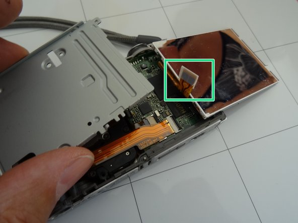

  11. Panasonic camera DMC FS 16 CCD cleaning: crwdns2935265:011crwdnd2935265:01crwdnd2935265:02crwdne2935265:0 Panasonic camera DMC FS 16 CCD cleaning: crwdns2935265:011crwdnd2935265:02crwdnd2935265:02crwdne2935265:0
    • Under the display is another shielding plate. It is attached with two 6.4 mm #000 Phillips screws. Remove those to remove the shield
    • Remove the shield
    • Not to be alarmed: An unused connection will be visible on the display. It is secured with insulating tape. When assembling, push this ribbon cable back under the shielding plate.
