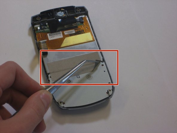

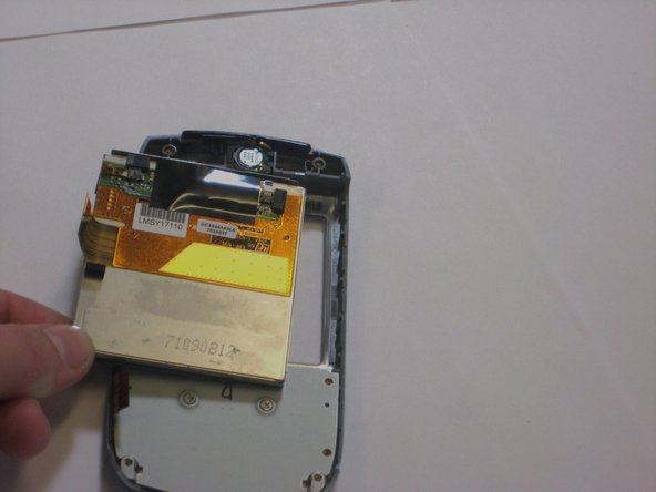

      • Use a pair of tweezers, to carefully peel off the silver tape from the screen.
      • Push the screen out of the back of the front panel to remove it.

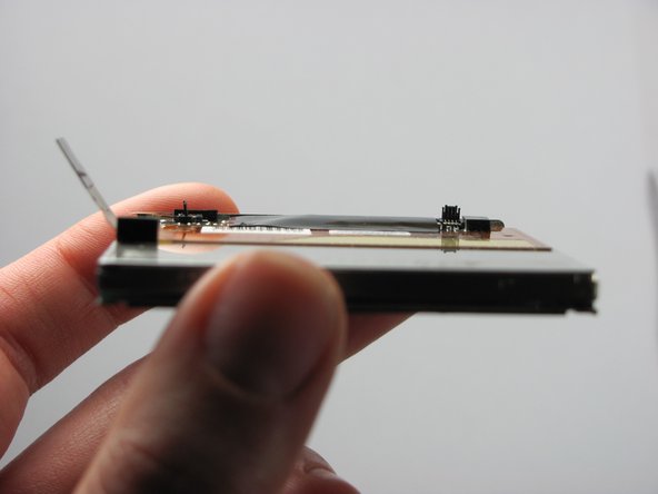

      • Use a small spudger to flip up both of the locking flaps that hold the orange ribbon cables in place.

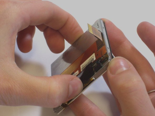

    3. Palm Treo 680 screen replacement: crwdns2935265:09crwdnd2935265:01crwdnd2935265:03crwdne2935265:0 Palm Treo 680 screen replacement: crwdns2935265:09crwdnd2935265:02crwdnd2935265:03crwdne2935265:0 Palm Treo 680 screen replacement: crwdns2935265:09crwdnd2935265:03crwdnd2935265:03crwdne2935265:0

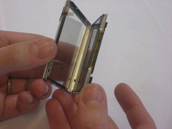

      • Flip the screen over 180 degrees and remove the metal piece that cushions the screen.
      • Flip the screen over again.
      • In the following step, you will only slightly pull the screens apart. Do not fully separate them yet.

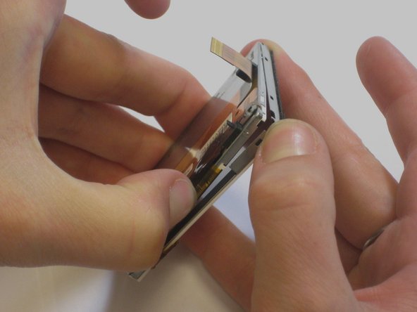

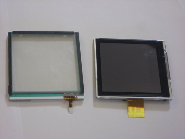

      • Carefully begin to pull apart the touch screen and LCD screen.
    4. Palm Treo 680 screen replacement: crwdns2935265:010crwdnd2935265:01crwdnd2935265:03crwdne2935265:0 Palm Treo 680 screen replacement: crwdns2935265:010crwdnd2935265:02crwdnd2935265:03crwdne2935265:0 Palm Treo 680 screen replacement: crwdns2935265:010crwdnd2935265:03crwdnd2935265:03crwdne2935265:0
      • Move your thumbs diagonally to the opposite corner of the screen and slightly pull apart the touch screen from the LCD screen.
      • Carefully peel the touch screen away from the LCD screen.
      • The touch screen and LCD screen should now be completely separated.
