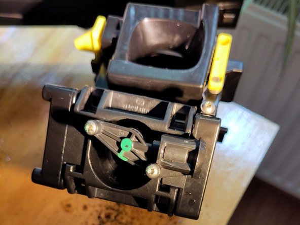

    • After a short run in a dry machine, water was leaking to the side of the machine, and inside a trail of droplets is seen along the brewing unit inside. At the top of the second photo, you can see a large droplet in the side panel.

    • This particular one had a strange issue: the feeding funnel connection to the exit tube faced the wrong direction, which meant rotating the top part of the brewing mechanism 180°. Perhaps it was from another machine, perhaps someone else reassembled it incorrectly.
  3. PHILIPS HD8829 coffee machine brewing unit exit funnel Replacement, Rotate the top of the brewing unit: crwdns2935265:03crwdnd2935265:01crwdnd2935265:02crwdne2935265:0 PHILIPS HD8829 coffee machine brewing unit exit funnel Replacement, Rotate the top of the brewing unit: crwdns2935265:03crwdnd2935265:02crwdnd2935265:02crwdne2935265:0
    • First remove the the feeding funnel by unscrewing the two torx screws.
    • Removing 3 sunken torx screws on the side of the brewing mechanism removes the side plate, so then it can be opened by tilting it a bit around the top part.
    • Assembling it in the right position, taking care that all moving parts sit right fixed the issue.
