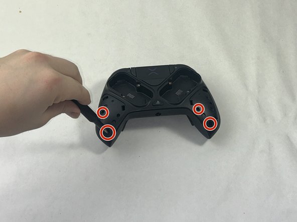

    • Use the purple Module Swap Tool that comes with the device to remove the 4 hex screws.
    • Remove the joystick/button modules from the controller.
