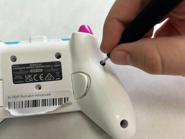

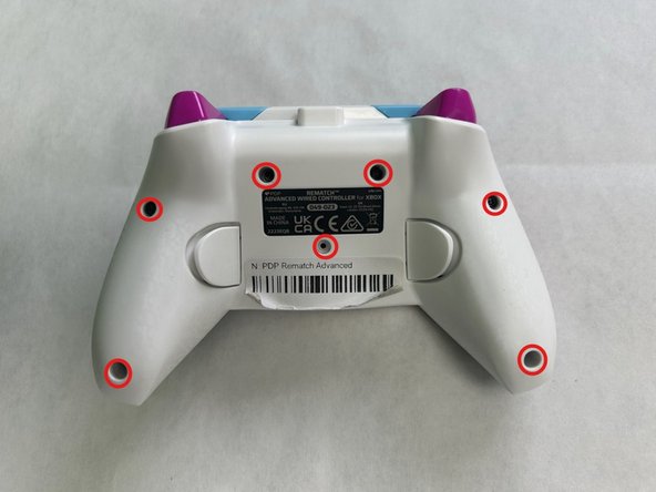

    • Orient the controller so the back side is facing up.
    • Use a Phillips #000 screwdriver to remove the seven 9 mm screws that secure the back shell.

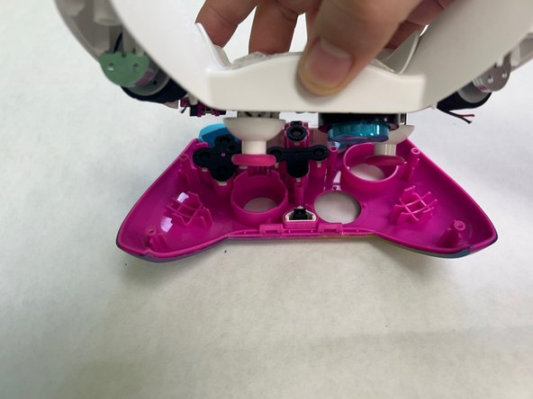

    • Make sure the front shell of the controller is facing your work surface to prevent the face buttons from falling out.

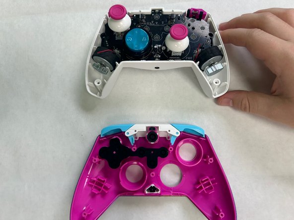

    • Pull apart the controller's front and back shell with moderate force.

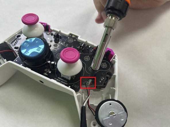

    • Use a soldering iron to desolder the two wires connecting the vibration motor to the motherboard.
    • Repeat for the other vibration motor if necessary.

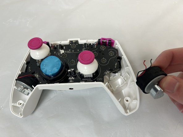

    • Grab the motor and pull away from the back shell to remove the vibration motor.
