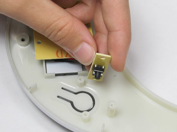

  10. Ozeri Pronto ZK14-S Button Replacement, Button: crwdns2935265:010crwdnd2935265:01crwdnd2935265:02crwdne2935265:0 Ozeri Pronto ZK14-S Button Replacement, Button: crwdns2935265:010crwdnd2935265:02crwdnd2935265:02crwdne2935265:0
    $5.49
    • Using a 2.0 Flathead screwdriver, remove the two 7.34 mm screws on the smaller motherboards.

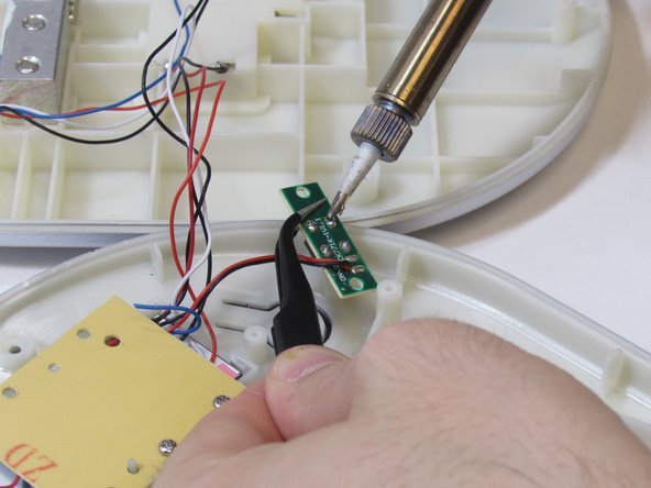

  11. Ozeri Pronto ZK14-S Button Replacement: crwdns2935265:011crwdnd2935265:01crwdnd2935265:02crwdne2935265:0 Ozeri Pronto ZK14-S Button Replacement: crwdns2935265:011crwdnd2935265:02crwdnd2935265:02crwdne2935265:0
    • Desolder the four posts in the center of the motherboard.
    • Caution: The tip of the soldering iron will be very hot

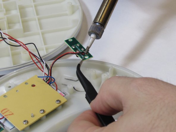

  12. Ozeri Pronto ZK14-S Button Replacement: crwdns2935265:012crwdnd2935265:01crwdnd2935265:02crwdne2935265:0 Ozeri Pronto ZK14-S Button Replacement: crwdns2935265:012crwdnd2935265:02crwdnd2935265:02crwdne2935265:0
    • Desolder the two clips in the center of the motherboard.
    • Repeat steps 13 and 14 to remove the other button from its motherboard.
