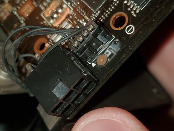

      • Underneath the heatsink, there is an additional 4-pin connector next to the 6-pin PCIe connector. This is for the fan; you will need to disconnect this when you separate the heat sink from the Printed Circuit Board (PCB).

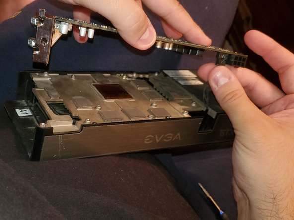

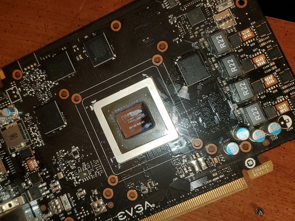

      • Unscrew all screws on the bottom of the graphics card. This will allow you to remove the heatsink from the graphics card.
      • Remove all screws of the heat sink, and do not forget to remove the screw located in the back corner of the graphic card.
      • You do not need to remove the screws for the extra cooling fan, but you must remove the screws fixing the PCB board with the heat sink together.
    4. Overheating Graphics Card Thermal Paste Replacement: crwdns2935265:04crwdnd2935265:01crwdnd2935265:03crwdne2935265:0 Overheating Graphics Card Thermal Paste Replacement: crwdns2935265:04crwdnd2935265:02crwdnd2935265:03crwdne2935265:0 Overheating Graphics Card Thermal Paste Replacement: crwdns2935265:04crwdnd2935265:03crwdnd2935265:03crwdne2935265:0
      • Gently pull on the heatsink to remove the heatsink from the graphics card.
      • Do not pull it too hard, as you will need to remove the cable from the heat sink's fan to separate the two pieces completely.
      • Next to where the 6-pin power connector is, is the fan connector. Handling the heat sink's fan cable from the sides, gently remove the cable from the slot.
      • If you pull the fan cable from the cable itself, you will likely destroy the fan cable.

      • Wipe the top of the graphics chip gently with 91% isopropyl alcohol to remove the old thermal paste, avoid being too rough to prevent scratching the chip.
    6. Overheating Graphics Card Thermal Paste Replacement: crwdns2935265:06crwdnd2935265:01crwdnd2935265:03crwdne2935265:0 Overheating Graphics Card Thermal Paste Replacement: crwdns2935265:06crwdnd2935265:02crwdnd2935265:03crwdne2935265:0 Overheating Graphics Card Thermal Paste Replacement: crwdns2935265:06crwdnd2935265:03crwdnd2935265:03crwdne2935265:0

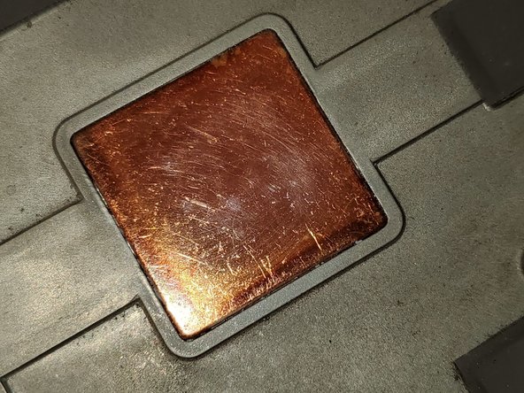

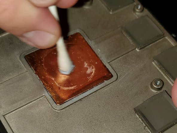

      • Repeat that process on the heatsink. This will allow for even distribution of the thermal paste to fill properly.
    7. Overheating Graphics Card Thermal Paste Replacement: crwdns2935265:07crwdnd2935265:01crwdnd2935265:03crwdne2935265:0 Overheating Graphics Card Thermal Paste Replacement: crwdns2935265:07crwdnd2935265:02crwdnd2935265:03crwdne2935265:0 Overheating Graphics Card Thermal Paste Replacement: crwdns2935265:07crwdnd2935265:03crwdnd2935265:03crwdne2935265:0

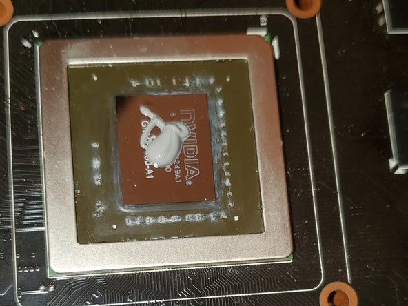

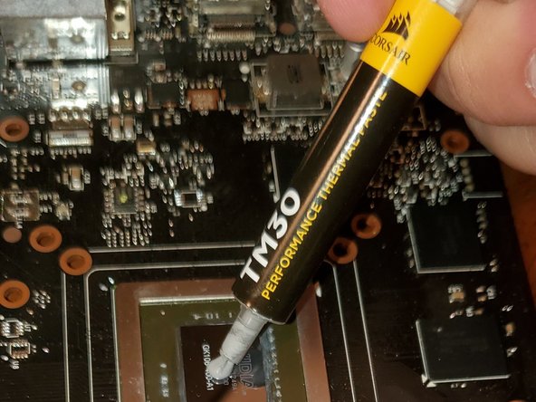

      • Place a small pea-sized drop of your new thermal paste on the graphic chip center.
      • Do not apply too much Thermal Paste, it can spill over the sides of the Graphic chip which can cause issues and it will be a mess to clean up.
      • Do not spread the paste before reassembling the graphic card with the cooler, the cooler pressure will evenly distribute the thermal paste.
