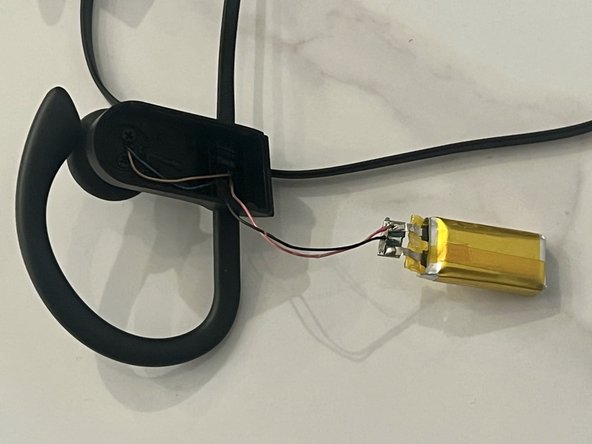

    • Power off your earbuds first.
    • Use a pry tool to unclip the cover of the left earbud.
  1. Otium Bluetooth Headphones Battery Replacement: crwdns2935265:02crwdnd2935265:01crwdnd2935265:02crwdne2935265:0 Otium Bluetooth Headphones Battery Replacement: crwdns2935265:02crwdnd2935265:02crwdnd2935265:02crwdne2935265:0
    • Carefully remove the battery from the housing.
    • The battery is connected by two fragile wires.
    • Shown is a 3.7v 100mAh Lithium Polymer (LiPo) battery.

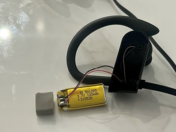

  2. Otium Bluetooth Headphones Battery Replacement: crwdns2935265:03crwdnd2935265:01crwdnd2935265:02crwdne2935265:0 Otium Bluetooth Headphones Battery Replacement: crwdns2935265:03crwdnd2935265:02crwdnd2935265:02crwdne2935265:0
    • Carefully peel back the rubber cover from the protection circuit module (PCM).
    • Remove the cover and save to re-use.
    • The rubber is attached using Kapton tape and hot glue.
  3. Otium Bluetooth Headphones Battery Replacement: crwdns2935265:04crwdnd2935265:01crwdnd2935265:02crwdne2935265:0 Otium Bluetooth Headphones Battery Replacement: crwdns2935265:04crwdnd2935265:02crwdnd2935265:02crwdne2935265:0
    • Carefully bend the PCM away from the battery to make desoldering the two wires easier.
    • Use a soldering iron to desolder the two wires from the PCM.
    • Adding a JST connector would make future repairs much easier!
    • Recycle your old battery!
