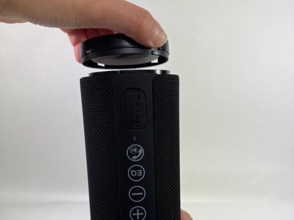

    • Use an opening tool to remove the rubber end caps.
  2. Ortizan X10 LED Board Replacement: crwdns2935265:02crwdnd2935265:01crwdnd2935265:03crwdne2935265:0 Ortizan X10 LED Board Replacement: crwdns2935265:02crwdnd2935265:02crwdnd2935265:03crwdne2935265:0 Ortizan X10 LED Board Replacement: crwdns2935265:02crwdnd2935265:03crwdnd2935265:03crwdne2935265:0

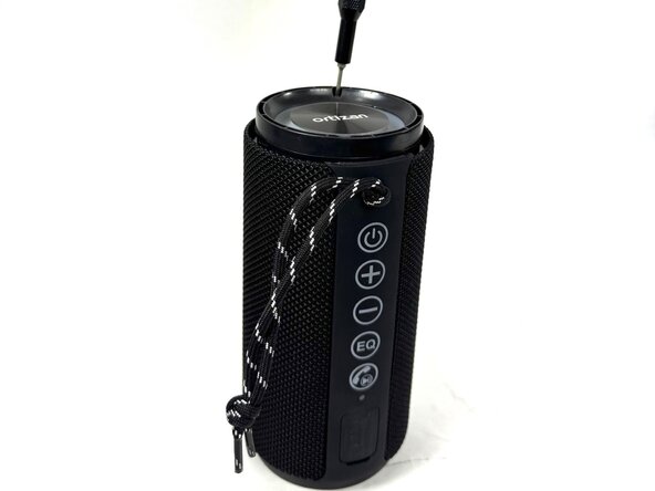

    • Use a Phillips screwdriver to remove the four screws (two on each end).
    • Firmly grip the top of the speaker, stabilize the base, and twist the cap counterclockwise to loosen and remove. Repeat this step for the bottom cap.

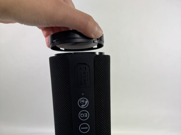

  3. Ortizan X10 LED Board Replacement: crwdns2935265:03crwdnd2935265:01crwdnd2935265:01crwdne2935265:0
    • Insert an opening tool into the seam between the grille and body. Lift and crack it open just a little.

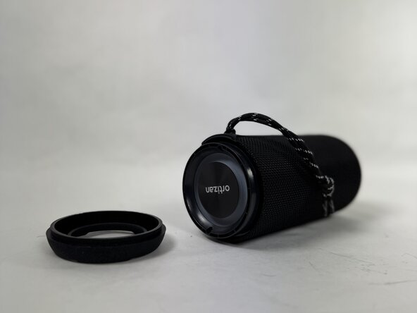

  4. Ortizan X10 LED Board Replacement: crwdns2935265:04crwdnd2935265:01crwdnd2935265:01crwdne2935265:0
    • Using your hands, pull the speaker out of the casing by holding the speaker in one hand and the shell in the other.

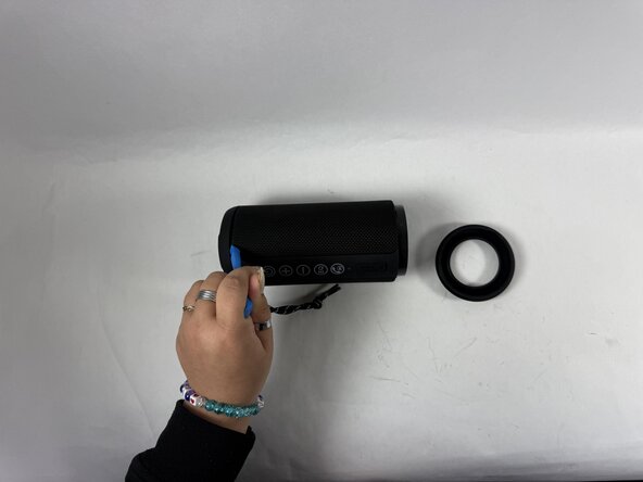

  5. Ortizan X10 LED Board Replacement, LED Board: crwdns2935265:05crwdnd2935265:01crwdnd2935265:02crwdne2935265:0 Ortizan X10 LED Board Replacement, LED Board: crwdns2935265:05crwdnd2935265:02crwdnd2935265:02crwdne2935265:0
    • You can use the iFixit Opening Tool to carefully remove the silicone protective covers at the speaker's top and bottom.
