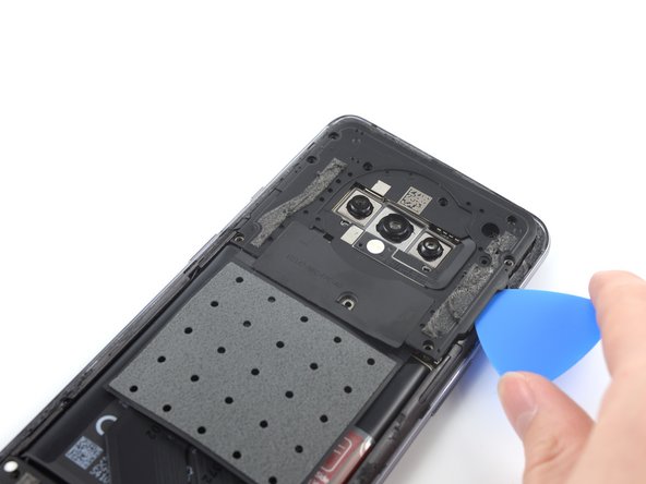

  8. OnePlus 7T Screen Replacement, Remove the rear glass: crwdns2935265:08crwdnd2935265:01crwdnd2935265:01crwdne2935265:0
    • Remove the rear glass.
    • Apply new adhesive where necessary after cleaning the relevant areas with isopropyl alcohol (>90%).
    • Secure the new back cover with pre-cut adhesive or double-sided adhesive tape. After installing the back cover, apply strong, steady pressure to your phone for several minutes to help the adhesive form a good bond—a stack of heavy books works well.

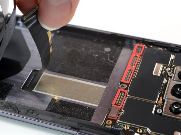

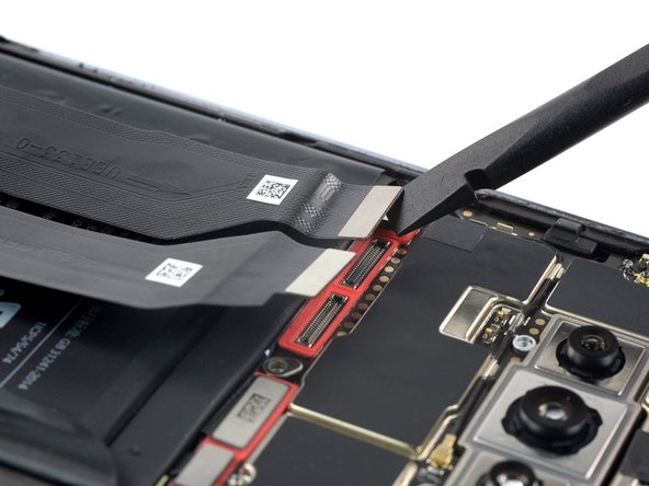

  12. OnePlus 7T Screen Replacement, Disconnect the flex cables: crwdns2935265:012crwdnd2935265:01crwdnd2935265:03crwdne2935265:0 OnePlus 7T Screen Replacement, Disconnect the flex cables: crwdns2935265:012crwdnd2935265:02crwdnd2935265:03crwdne2935265:0 OnePlus 7T Screen Replacement, Disconnect the flex cables: crwdns2935265:012crwdnd2935265:03crwdnd2935265:03crwdne2935265:0
    • Use the flat end of a spudger to disconnect the two flex cables.

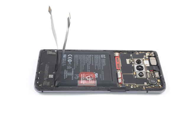

  13. OnePlus 7T Screen Replacement, Reposition the flex cables: crwdns2935265:013crwdnd2935265:01crwdnd2935265:03crwdne2935265:0 OnePlus 7T Screen Replacement, Reposition the flex cables: crwdns2935265:013crwdnd2935265:02crwdnd2935265:03crwdne2935265:0 OnePlus 7T Screen Replacement, Reposition the flex cables: crwdns2935265:013crwdnd2935265:03crwdnd2935265:03crwdne2935265:0
    • Bend the two flex cables toward the bottom of the phone and out of the way of the battery.
    • Avoid folding or sharply bending the cables as you reposition them. Doing so could damage the cables.

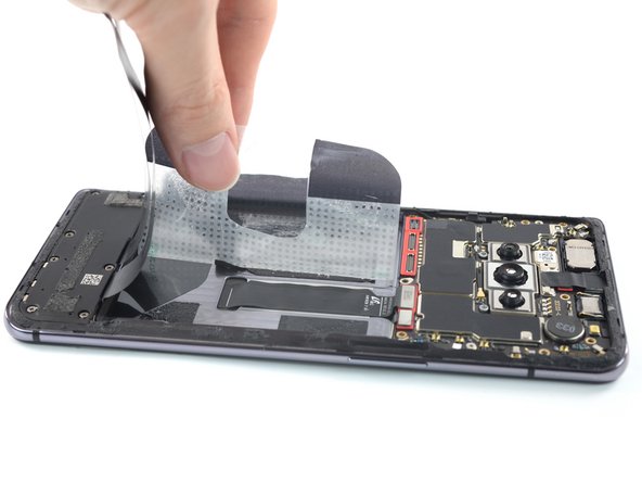

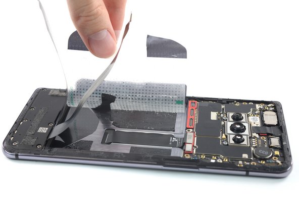

  17. OnePlus 7T Screen Replacement, Remove the plastic film: crwdns2935265:017crwdnd2935265:01crwdnd2935265:03crwdne2935265:0 OnePlus 7T Screen Replacement, Remove the plastic film: crwdns2935265:017crwdnd2935265:02crwdnd2935265:03crwdne2935265:0 OnePlus 7T Screen Replacement, Remove the plastic film: crwdns2935265:017crwdnd2935265:03crwdnd2935265:03crwdne2935265:0
    • Grab the edge of the film sticking out on the right side of the phone.
    • Pull the film towards the left side of the phone with steady force.
    • Remove the plastic film.

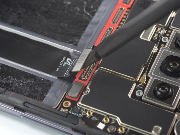

  18. OnePlus 7T Screen Replacement, Disconnect the screen: crwdns2935265:018crwdnd2935265:01crwdnd2935265:02crwdne2935265:0 OnePlus 7T Screen Replacement, Disconnect the screen: crwdns2935265:018crwdnd2935265:02crwdnd2935265:02crwdne2935265:0
    • Use a spudger to disconnect the screen by prying the connector straight up from its socket.

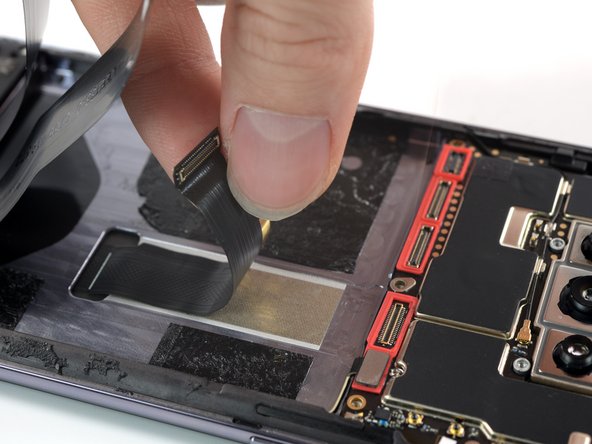

  19. OnePlus 7T Screen Replacement, Separate the display cable: crwdns2935265:019crwdnd2935265:01crwdnd2935265:03crwdne2935265:0 OnePlus 7T Screen Replacement, Separate the display cable: crwdns2935265:019crwdnd2935265:02crwdnd2935265:03crwdne2935265:0 OnePlus 7T Screen Replacement, Separate the display cable: crwdns2935265:019crwdnd2935265:03crwdnd2935265:03crwdne2935265:0
    • The display cable is lightly adhered to the frame.
    • Grab the display cable with your fingers.
    • Pull the display cable toward the bottom of the phone.
    • Avoid folding or sharply bending the cable. Doing so could damage the cable.

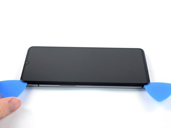

  20. OnePlus 7T Screen Replacement, Heat the screen: crwdns2935265:020crwdnd2935265:01crwdnd2935265:01crwdne2935265:0
    • Heat an iOpener and apply it to the screen for two minutes.
    • A hair dryer, heat gun, or hot plate may also be used, but be careful not to overheat the phone—the display and internal battery are both susceptible to heat damage.

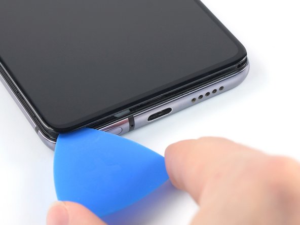

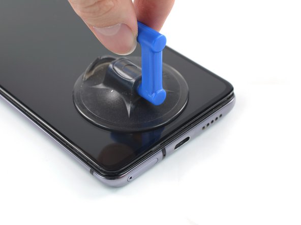

  21. OnePlus 7T Screen Replacement, Insert an opening pick: crwdns2935265:021crwdnd2935265:01crwdnd2935265:03crwdne2935265:0 OnePlus 7T Screen Replacement, Insert an opening pick: crwdns2935265:021crwdnd2935265:02crwdnd2935265:03crwdne2935265:0 OnePlus 7T Screen Replacement, Insert an opening pick: crwdns2935265:021crwdnd2935265:03crwdnd2935265:03crwdne2935265:0
    • Apply a suction handle to the bottom of the screen.
    • If your display is badly cracked, covering it with a layer of clear packing tape may allow the suction cup to adhere. Alternatively, very strong tape may be used instead of the suction cup. If all else fails, you can superglue the suction cup to the broken screen.
    • Pull the suction cup up with strong, steady force to create a gap.
    • Insert an opening pick into the gap.
  22. OnePlus 7T Screen Replacement, Slice the adhesive: crwdns2935265:022crwdnd2935265:01crwdnd2935265:03crwdne2935265:0 OnePlus 7T Screen Replacement, Slice the adhesive: crwdns2935265:022crwdnd2935265:02crwdnd2935265:03crwdne2935265:0 OnePlus 7T Screen Replacement, Slice the adhesive: crwdns2935265:022crwdnd2935265:03crwdnd2935265:03crwdne2935265:0
    • Slide the opening pick along the bottom edge to separate the adhesive.
    • Leave the opening pick in the bottom left corner to prevent the adhesive from resealing.

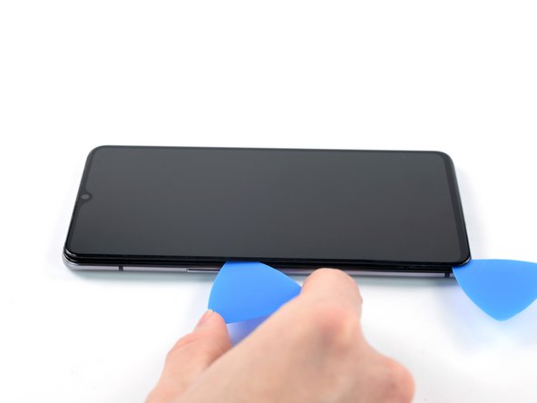

  23. OnePlus 7T Screen Replacement: crwdns2935265:023crwdnd2935265:01crwdnd2935265:03crwdne2935265:0 OnePlus 7T Screen Replacement: crwdns2935265:023crwdnd2935265:02crwdnd2935265:03crwdne2935265:0 OnePlus 7T Screen Replacement: crwdns2935265:023crwdnd2935265:03crwdnd2935265:03crwdne2935265:0
    • Insert a second opening pick at the bottom left corner.
    • Slide the opening pick along the left edge to the top left corner.
    • Leave the opening pick in the top left corner to prevent the adhesive from resealing.

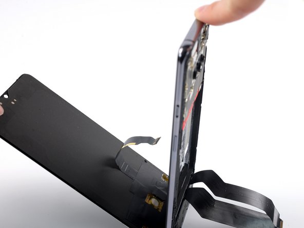

  26. OnePlus 7T Screen Replacement, Remove the screen: crwdns2935265:026crwdnd2935265:01crwdnd2935265:03crwdne2935265:0 OnePlus 7T Screen Replacement, Remove the screen: crwdns2935265:026crwdnd2935265:02crwdnd2935265:03crwdne2935265:0 OnePlus 7T Screen Replacement, Remove the screen: crwdns2935265:026crwdnd2935265:03crwdnd2935265:03crwdne2935265:0
    • Grab the display on the top and slowly pull the screen away from the frame.
    • If your screen is still sticking to the frame, slide the pick around the edges of the phone until the screen completely separates.
    • Thread the display flex cable through the gap in the frame.
    • Remove the screen.
