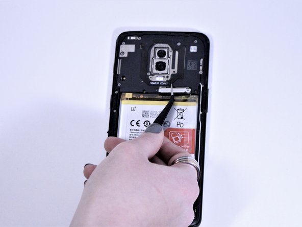

    • Remove the single 3mm Phillips #00 screws holding the metal battery cover on the phone.
    • Use tweezers to remove the battery cover and place it to the side.
