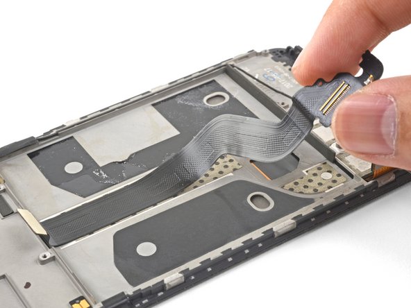

  17. OnePlus 5 Screen and Digitizer Assembly Replacement, OnePlus 5 Interconnect Cable Disconnect: crwdns2935265:017crwdnd2935265:01crwdnd2935265:03crwdne2935265:0 OnePlus 5 Screen and Digitizer Assembly Replacement, OnePlus 5 Interconnect Cable Disconnect: crwdns2935265:017crwdnd2935265:02crwdnd2935265:03crwdne2935265:0 OnePlus 5 Screen and Digitizer Assembly Replacement, OnePlus 5 Interconnect Cable Disconnect: crwdns2935265:017crwdnd2935265:03crwdnd2935265:03crwdne2935265:0
    • Use the point of a spudger to pry up and disconnect the interconnect flex cable from the socket.
    • If you are replacing the battery, bend the interconnect flex cable away from the phone and secure it out of the way with a rubber band or tape.

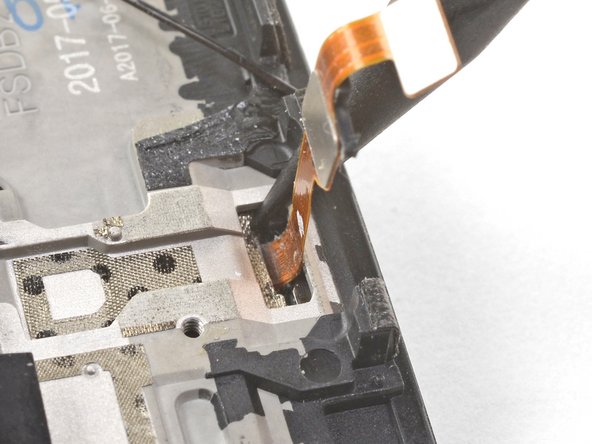

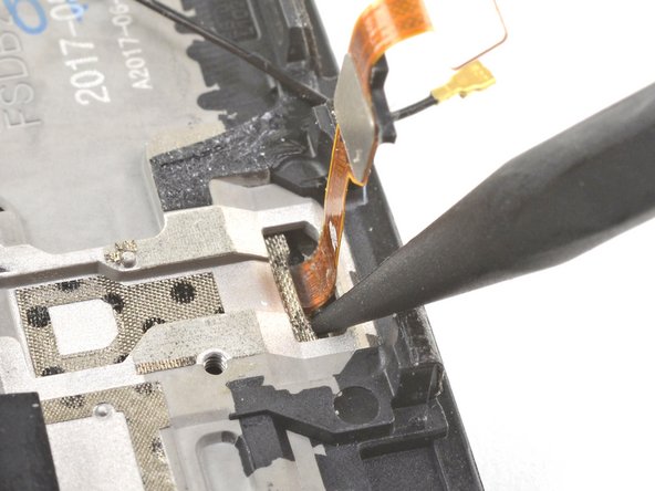

  28. OnePlus 5 Screen and Digitizer Assembly Replacement: crwdns2935265:028crwdnd2935265:01crwdnd2935265:02crwdne2935265:0 OnePlus 5 Screen and Digitizer Assembly Replacement: crwdns2935265:028crwdnd2935265:02crwdnd2935265:02crwdne2935265:0
    • If you are planning to reuse the fingerprint scanner, be extremely careful pulling the flex cable up. It is very delicate and prone to breaking.
    • Use your finger to gently lift up the connector end of the fingerprint scanner. Pull upwards slowly. Do not pull directly away from the fingerprint scanner.
    • Keep pulling upwards until the fingerprint scanner cable is freed from its recess.
  29. OnePlus 5 Screen and Digitizer Assembly Replacement: crwdns2935265:029crwdnd2935265:01crwdnd2935265:03crwdne2935265:0 OnePlus 5 Screen and Digitizer Assembly Replacement: crwdns2935265:029crwdnd2935265:02crwdnd2935265:03crwdne2935265:0 OnePlus 5 Screen and Digitizer Assembly Replacement: crwdns2935265:029crwdnd2935265:03crwdnd2935265:03crwdne2935265:0
    • Insert the point of a spudger into the marked areas on either side of the flex cable, and push until the fingerprint scanner is loosened from its recess.
    • Do not apply pressure directly onto the delicate flex cable.
    • If the fingerprint scanner is not coming loose, make sure you are pressing the spudger's point against the backside of the scanner as indicated in the first image, and not the metal plate below it.

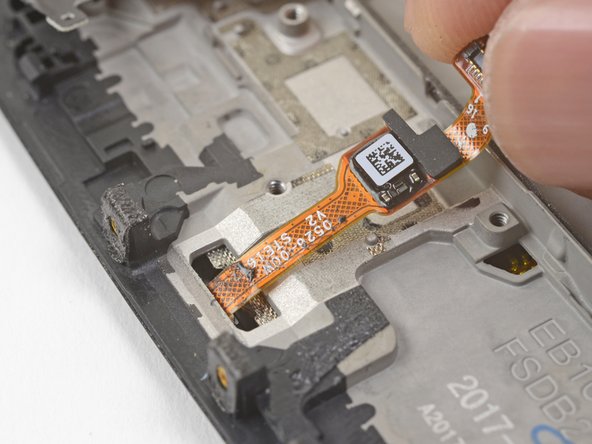

  30. OnePlus 5 Screen and Digitizer Assembly Replacement: crwdns2935265:030crwdnd2935265:01crwdnd2935265:02crwdne2935265:0 OnePlus 5 Screen and Digitizer Assembly Replacement: crwdns2935265:030crwdnd2935265:02crwdnd2935265:02crwdne2935265:0
    • Once the fingerprint scanner is loosened from its recess, carefully thread its flex cable through the cutout, out of the front of the display.
    • Remove the fingerprint scanner.
    • If you are installing the fingerprint scanner onto a replacement frame, be sure to peel off the blue adhesive liner for the fingerprint scanner before sticking it in place.

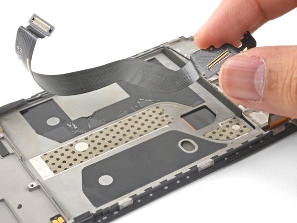

  31. OnePlus 5 Screen and Digitizer Assembly Replacement, Motherboard: crwdns2935265:031crwdnd2935265:01crwdnd2935265:02crwdne2935265:0 OnePlus 5 Screen and Digitizer Assembly Replacement, Motherboard: crwdns2935265:031crwdnd2935265:02crwdnd2935265:02crwdne2935265:0
    • Use the point of a spudger to pry up and disconnect the display interconnect cable from its socket near the bottom edge of the motherboard.
  32. OnePlus 5 Screen and Digitizer Assembly Replacement: crwdns2935265:032crwdnd2935265:01crwdnd2935265:02crwdne2935265:0 OnePlus 5 Screen and Digitizer Assembly Replacement: crwdns2935265:032crwdnd2935265:02crwdnd2935265:02crwdne2935265:0
    • Slide the point of a spudger underneath the antenna interconnect cable that is connected to the motherboard above the vibration motor.
    • Pry up to disconnect the cable from its socket.
    • De-route the cable out of its motherboard grounding clip and move it out of the way.

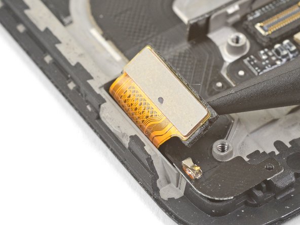

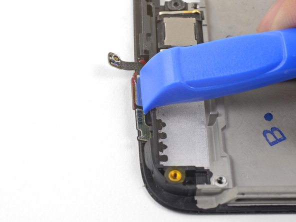

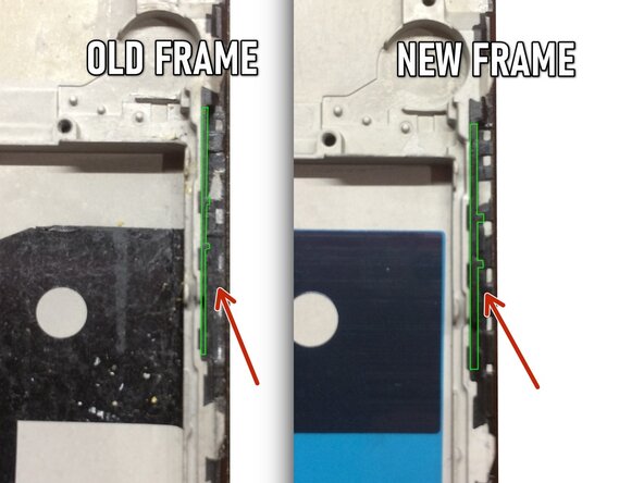

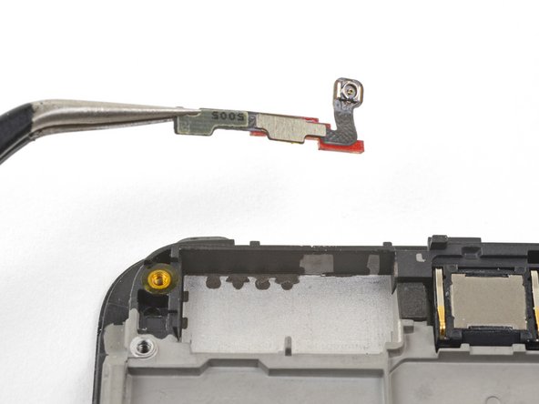

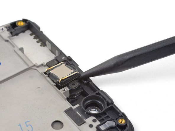

  36. OnePlus 5 Screen and Digitizer Assembly Replacement, Earpiece Speaker: crwdns2935265:036crwdnd2935265:01crwdnd2935265:02crwdne2935265:0 OnePlus 5 Screen and Digitizer Assembly Replacement, Earpiece Speaker: crwdns2935265:036crwdnd2935265:02crwdnd2935265:02crwdne2935265:0
    • Insert the point of a spudger under the top right corner of the earpiece module and pry up, loosening the module from its recess.
  37. OnePlus 5 Screen and Digitizer Assembly Replacement: crwdns2935265:037crwdnd2935265:01crwdnd2935265:01crwdne2935265:0
    • Remove the earpiece module.
    • During reinstallation, be sure that the earpiece module is properly oriented such that the gold contacts face downwards.
    • If you are transferring the earpiece module to a replacement frame, be sure to peel and remove the white adhesive liner before pressing the earpiece module into place.

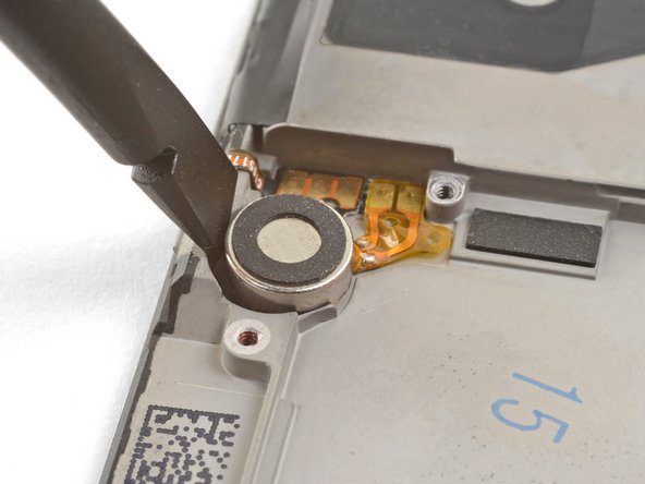

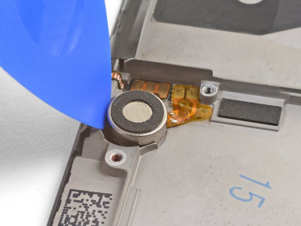

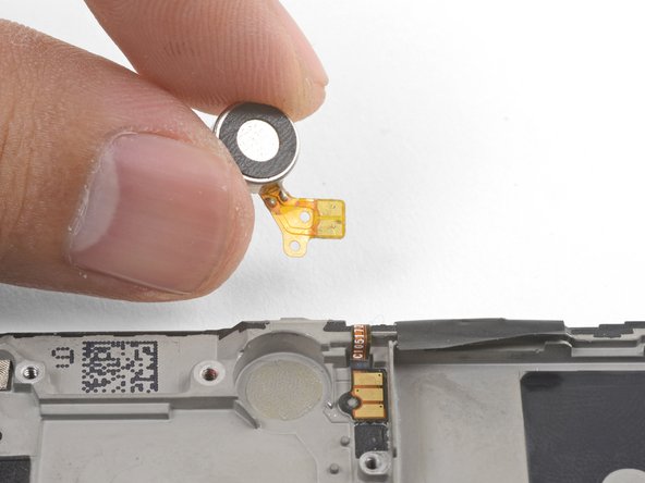

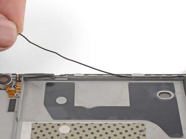

  38. OnePlus 5 Screen and Digitizer Assembly Replacement, Vibration Motor: crwdns2935265:038crwdnd2935265:01crwdnd2935265:03crwdne2935265:0 OnePlus 5 Screen and Digitizer Assembly Replacement, Vibration Motor: crwdns2935265:038crwdnd2935265:02crwdnd2935265:03crwdne2935265:0 OnePlus 5 Screen and Digitizer Assembly Replacement, Vibration Motor: crwdns2935265:038crwdnd2935265:03crwdnd2935265:03crwdne2935265:0
    • Wedge the point of an opening pick between the vibration motor and the frame and push downward to loosen the vibration motor from its recess.
    • Once the vibration motor is slightly loosened, you can wedge the flat end of a spudger between the motor and the frame to help free it from its recess.
  39. OnePlus 5 Screen and Digitizer Assembly Replacement: crwdns2935265:039crwdnd2935265:01crwdnd2935265:02crwdne2935265:0 OnePlus 5 Screen and Digitizer Assembly Replacement: crwdns2935265:039crwdnd2935265:02crwdnd2935265:02crwdne2935265:0
    • Slide the point of an opening pick underneath the vibration motor's flex pad and gently pry it off of the frame.
    • Remove the vibration motor.

    • Use the point of a spudger to pry up the display connector from its socket near the bottom left corner of the frame.
  46. OnePlus 5 Screen and Digitizer Assembly Replacement: crwdns2935265:046crwdnd2935265:01crwdnd2935265:03crwdne2935265:0 OnePlus 5 Screen and Digitizer Assembly Replacement: crwdns2935265:046crwdnd2935265:02crwdnd2935265:03crwdne2935265:0 OnePlus 5 Screen and Digitizer Assembly Replacement: crwdns2935265:046crwdnd2935265:03crwdnd2935265:03crwdne2935265:0
    • Insert the flat end of a spudger underneath the display interconnect cable socket, near where it connected with the display connector in the bottom left corner of the frame.
    • Pry upwards and slide the spudger underneath the cable to loosen the cable from the frame.
  47. OnePlus 5 Screen and Digitizer Assembly Replacement: crwdns2935265:047crwdnd2935265:01crwdnd2935265:03crwdne2935265:0 OnePlus 5 Screen and Digitizer Assembly Replacement: crwdns2935265:047crwdnd2935265:02crwdnd2935265:03crwdne2935265:0 OnePlus 5 Screen and Digitizer Assembly Replacement: crwdns2935265:047crwdnd2935265:03crwdnd2935265:03crwdne2935265:0
    • Grasp the loosened end of the display interconnect cable with your fingers and pull upwards, releasing the cable from the frame.
    • Remove the display interconnect cable.
    • If you are transferring this onto a replacement frame, peel and remove the blue adhesive liners before sticking the cable in place.
  48. OnePlus 5 Screen and Digitizer Assembly Replacement: crwdns2935265:048crwdnd2935265:01crwdnd2935265:02crwdne2935265:0 OnePlus 5 Screen and Digitizer Assembly Replacement: crwdns2935265:048crwdnd2935265:02crwdnd2935265:02crwdne2935265:0
    • Use your fingers to lift and de-route the antenna interconnect cable from its groove on the right edge of the frame.
    • Transfer the antenna interconnect cable to the new frame.
  49. OnePlus 5 Screen and Digitizer Assembly Replacement: crwdns2935265:049crwdnd2935265:01crwdnd2935265:03crwdne2935265:0 OnePlus 5 Screen and Digitizer Assembly Replacement: crwdns2935265:049crwdnd2935265:02crwdnd2935265:03crwdne2935265:0 OnePlus 5 Screen and Digitizer Assembly Replacement: crwdns2935265:049crwdnd2935265:03crwdnd2935265:03crwdne2935265:0
    • Use the edge of an opening tool to push the back cover antenna connector away from the frame. It is located on the top edge of the frame.
    • Remove the back cover antenna connector.
    • If you are transferring the connector onto a replacement frame, peel the blue liner on the top edge of the replacement frame before sticking the connector onto the edge.

    • The bare screen and digitizer assembly remains.
    • Transfer all of the parts you removed in the previous steps from the old assembly to the new one.
    • Check the thickness of border between the battery and volume buttons! This thickness may differ between the old and new screen frame. This can cause the volume buttons to be pinched when assembly is done. If the border is thicker on the new frame, you need to gently scrape plastic in the places where the two buttons will be physically located.
