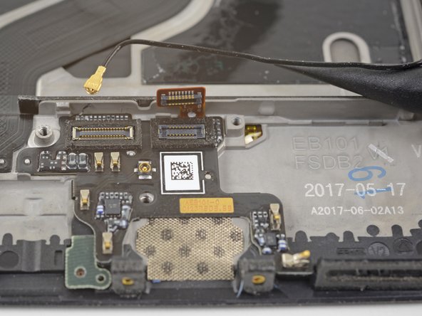

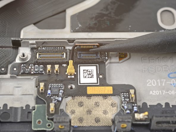

    1. OnePlus 5 Daughterboard Replacement, Daughterboard: crwdns2935265:018crwdnd2935265:01crwdnd2935265:02crwdne2935265:0 OnePlus 5 Daughterboard Replacement, Daughterboard: crwdns2935265:018crwdnd2935265:02crwdnd2935265:02crwdne2935265:0
      • Use the point of a spudger the pry up and disconnect the fingerprint scanner connector from its socket on the daughterboard.

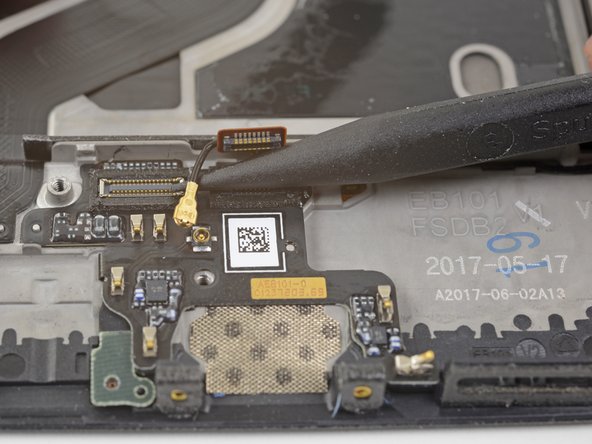

    2. OnePlus 5 Daughterboard Replacement: crwdns2935265:019crwdnd2935265:01crwdnd2935265:03crwdne2935265:0 OnePlus 5 Daughterboard Replacement: crwdns2935265:019crwdnd2935265:02crwdnd2935265:03crwdne2935265:0 OnePlus 5 Daughterboard Replacement: crwdns2935265:019crwdnd2935265:03crwdnd2935265:03crwdne2935265:0
      • Slip the point of a spudger underneath the antenna interconnect cable and pry up to disconnect it from its socket on the daughterboard.
      • De-route the antenna interconnect cable out of the way of the daughterboard.
