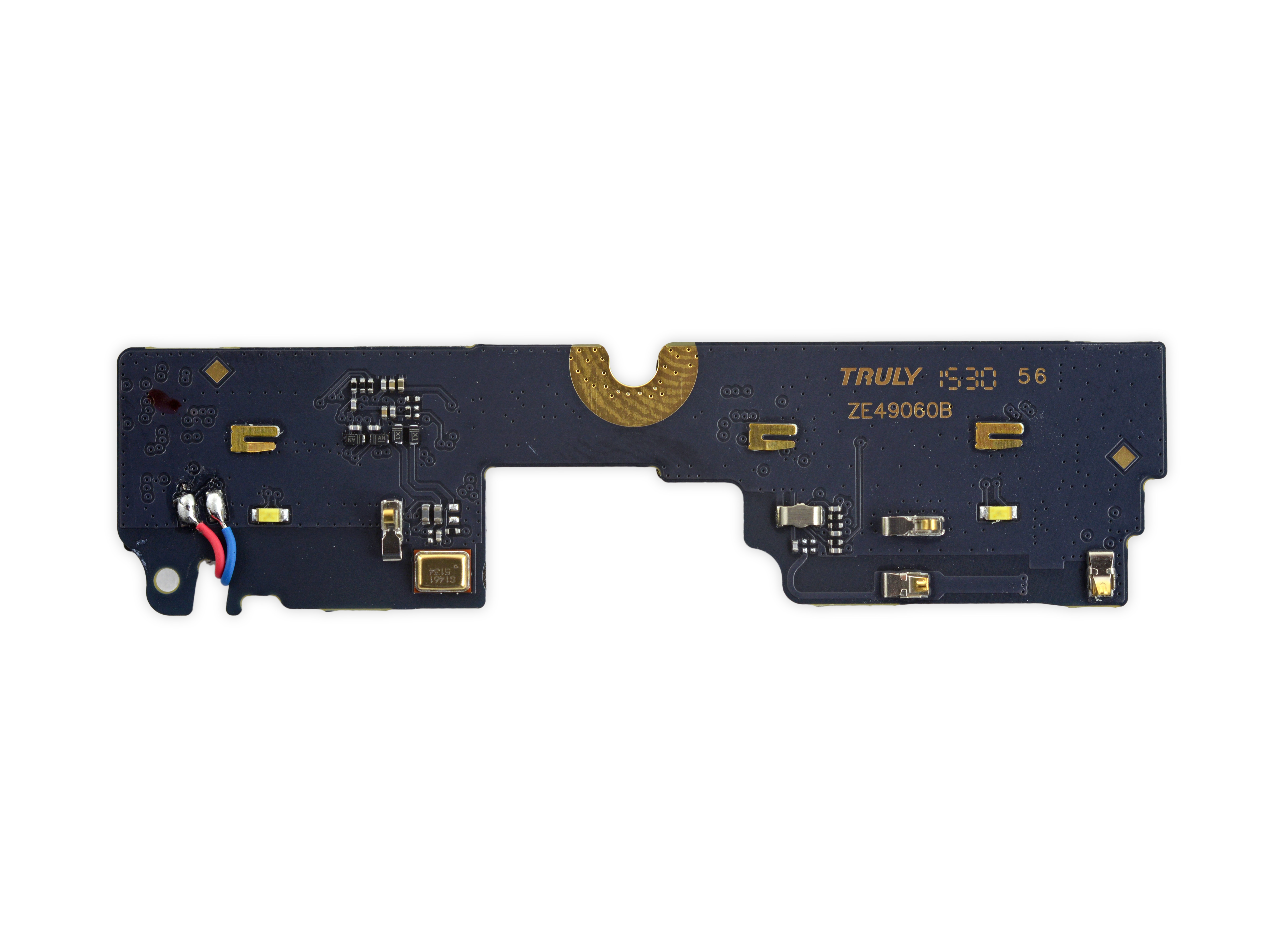

    14. OnePlus 2 Teardown: crwdns2935265:014crwdnd2935265:01crwdnd2935265:03crwdne2935265:0 OnePlus 2 Teardown: crwdns2935265:014crwdnd2935265:02crwdnd2935265:03crwdne2935265:0 OnePlus 2 Teardown: crwdns2935265:014crwdnd2935265:03crwdnd2935265:03crwdne2935265:0
      • Under the charging port cable, we strike daughterboard. Eureka!
      • The little foam foundation is the speaker box for that loudspeaker we spied in the midframe.
      • The daughterboard also houses a familiar classic: a coin-style vibration motor. Unfortunately, you'll need a soldering iron to replace it.
      • On the backside we find yet more spring contacts, a microphone, and the soft button LEDs. Like the motherboard, this daughter is a busy board.
