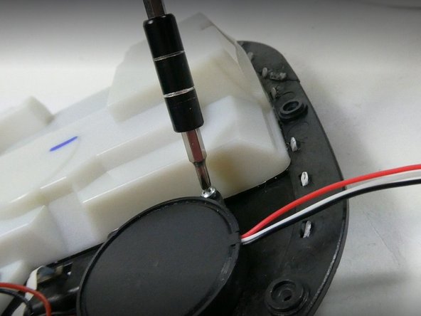

  6. OneLink Safe and Sound Microphone Replacement, Microphone: crwdns2935265:06crwdnd2935265:01crwdnd2935265:02crwdne2935265:0 OneLink Safe and Sound Microphone Replacement, Microphone: crwdns2935265:06crwdnd2935265:02crwdnd2935265:02crwdne2935265:0
    • Use a Phillips #0 screwdriver to remove the two screws that secure the microphone to the device.
  7. OneLink Safe and Sound Microphone Replacement: crwdns2935265:07crwdnd2935265:01crwdnd2935265:01crwdne2935265:0
    • Use your hands to remove the microphone.
