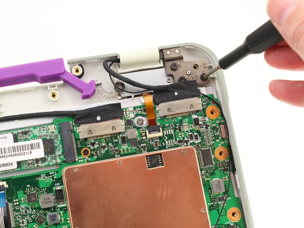

    • Lift up both hinges, ensuring that they clear all tape and wires.

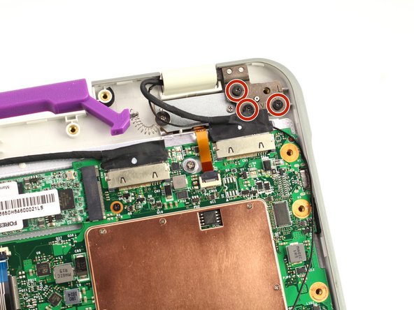

    • Flip the laptop over to expose the open bottom case.
    • Remove the six 5.6 mm Phillips #00 screws from the hinge brackets on the bottom case.

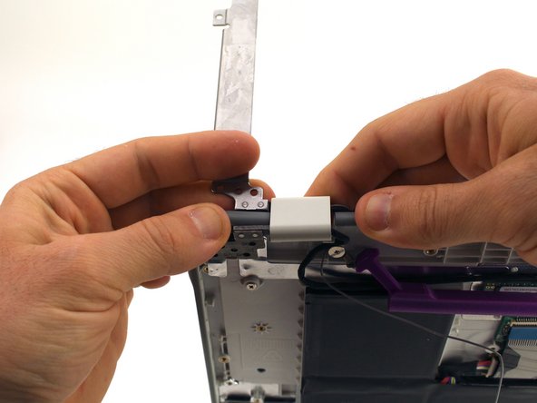

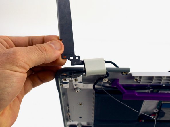

    • With the hinge still at a 90º angle, pull the hinge assembly clear from the bottom case.
    • You will need to apply a modest amount of force to squeeze the edge of the case between the two mounting brackets of the hinge.

    • Use a spudger to pop out a white plastic cable retaining bit from the hinge body.
    • Pull the cables out from the hinge body.
  16. One Education Infinity Hinge Assembly Replacement: crwdns2935265:016crwdnd2935265:01crwdnd2935265:01crwdne2935265:0
    • Remove the hinge assembly from the device.
    • Repeat the same steps for the other side.
