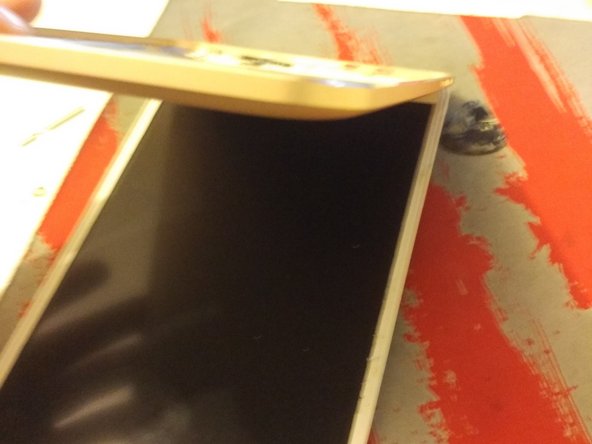

  1. Onda V80 Plus Touchscreen Replacement, The slab: crwdns2935265:01crwdnd2935265:01crwdnd2935265:02crwdne2935265:0 Onda V80 Plus Touchscreen Replacement, The slab: crwdns2935265:01crwdnd2935265:02crwdnd2935265:02crwdne2935265:0
    • Having already removed screen (of the strong way) by removing it from the front and removing pieces of glasses by pieces of glasses. I strongly advise against this method, I have, because of this method, damaged the LCD, the latter being very fragile, be careful. (Blue marks on picture 2)

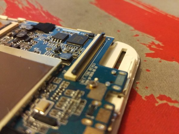

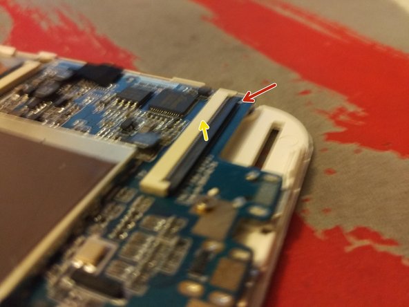

  3. Onda V80 Plus Touchscreen Replacement, disconnections: crwdns2935265:03crwdnd2935265:01crwdnd2935265:03crwdne2935265:0 Onda V80 Plus Touchscreen Replacement, disconnections: crwdns2935265:03crwdnd2935265:02crwdnd2935265:03crwdne2935265:0 Onda V80 Plus Touchscreen Replacement, disconnections: crwdns2935265:03crwdnd2935265:03crwdnd2935265:03crwdne2935265:0
    • After that, be careful not to lose the Power buttons, and Volume +/-
    • Remove the battery connector. Shoot from the red arrows on the photo, towards the yellow.
    • The touch screen connector is located at the top left. Gently lift the black part of the connector, then remove the tablecloth
