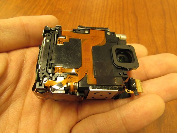

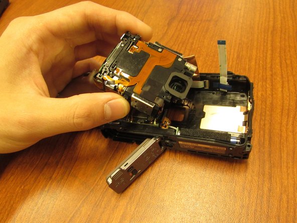

  8. Olympus Tough TG-1 Lens Box Replacement, Lens Box: crwdns2935265:08crwdnd2935265:01crwdnd2935265:01crwdne2935265:0
    • Locate the lens box attached to the motherboard.
  9. Olympus Tough TG-1 Lens Box Replacement: crwdns2935265:09crwdnd2935265:01crwdnd2935265:03crwdne2935265:0 Olympus Tough TG-1 Lens Box Replacement: crwdns2935265:09crwdnd2935265:02crwdnd2935265:03crwdne2935265:0 Olympus Tough TG-1 Lens Box Replacement: crwdns2935265:09crwdnd2935265:03crwdnd2935265:03crwdne2935265:0
    • Lift the copper foiled ribbon away from the lens box.
    • Detach the box by unclipping the ribbons connected to the motherboard.
    • Lift the box out of the camera.
