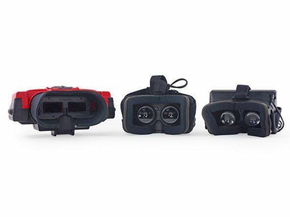

  3. Oculus Rift Development Kit 2 Teardown: crwdns2935265:03crwdnd2935265:01crwdnd2935265:03crwdne2935265:0 Oculus Rift Development Kit 2 Teardown: crwdns2935265:03crwdnd2935265:02crwdnd2935265:03crwdne2935265:0 Oculus Rift Development Kit 2 Teardown: crwdns2935265:03crwdnd2935265:03crwdnd2935265:03crwdne2935265:0
    • We have an ocular face off! Development kits 1 and 2 have a staring contest, giving us time for a quick comparison.
    • The first thing we notice is that DK2 shows some noticeable streamlining in size and shape.
    • Without warning, the forefather of VR headsets crashes the party—the Virtual Boy.
    • It's a fight to the virtual death! The contenders weigh in at:
    • 896 g for the Virtual Boy, making it the heavyweight champ (although, to be fair, this was never supposed to hang off of your face)
    • 453 g for the newcomer to the ring, the DK2
    • 395 g for last year's lightweight fighter, the original Rift

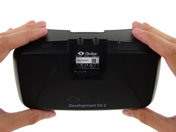

  6. Oculus Rift Development Kit 2 Teardown: crwdns2935265:06crwdnd2935265:01crwdnd2935265:03crwdne2935265:0 Oculus Rift Development Kit 2 Teardown: crwdns2935265:06crwdnd2935265:02crwdnd2935265:03crwdne2935265:0 Oculus Rift Development Kit 2 Teardown: crwdns2935265:06crwdnd2935265:03crwdnd2935265:03crwdne2935265:0
    • Tucked away under a rubber cover in the front, we find the USB accessory port and an additional sync cable port.
    • Time to de-face the Oculus: we remove several Phillips #0 screws securing the device itself to its adjustable headband.

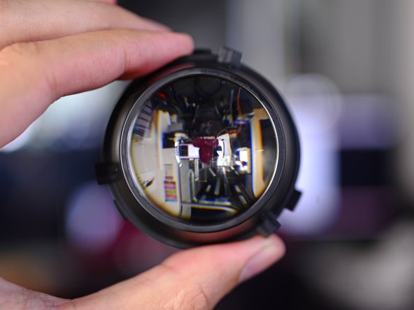

    • Within the faceplate, we find two new and improved lenses. The lenses have increased in size to accommodate a wider IPD (interpupillary distance) range.
    • After 150 years of development in VR, we have finally found a way to make the Oculus even more realistic... It's like everything's right in front of you, in full 3D!
    • If you own a DK2, using it to watch this video could result in an irreversible recursive cognitive paradox.

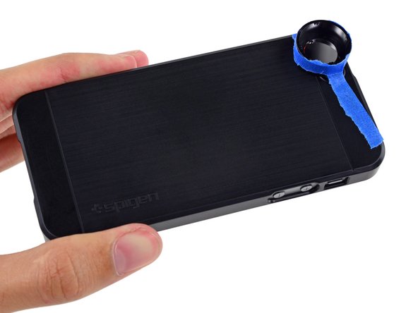

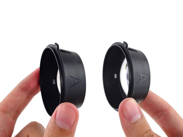

  7. Oculus Rift Development Kit 2 Teardown: crwdns2935265:08crwdnd2935265:01crwdnd2935265:03crwdne2935265:0 Oculus Rift Development Kit 2 Teardown: crwdns2935265:08crwdnd2935265:02crwdnd2935265:03crwdne2935265:0 Oculus Rift Development Kit 2 Teardown: crwdns2935265:08crwdnd2935265:03crwdnd2935265:03crwdne2935265:0
    • Thankfully, removing the interchangeable lenses remains a straightforward affair: twist and lift.
    • For those gamers who sport geek-chic glasses, the Oculus team has included different eyecups of varying focal lengths, just like it did in the Oculus VR, though this isn't a perfect solution.
    • With the lenses removed, there is no end to the light-bending experiments we can perform.
    • Naturally we took the opportunity to trap fellow tech writers in a tiny upside-down world! Science is awesome.
  8. Oculus Rift Development Kit 2 Teardown: crwdns2935265:09crwdnd2935265:01crwdnd2935265:03crwdne2935265:0 Oculus Rift Development Kit 2 Teardown: crwdns2935265:09crwdnd2935265:02crwdnd2935265:03crwdne2935265:0 Oculus Rift Development Kit 2 Teardown: crwdns2935265:09crwdnd2935265:03crwdnd2935265:03crwdne2935265:0
    • This svelte cable cover slides out with nary a complaint, making the Mini USB and HDMI cables surprisingly easy to disconnect.
    • In terms of a model number, these FCC labels yield nothing but "Rift DK2."
    • Simplicity: we can haz it.

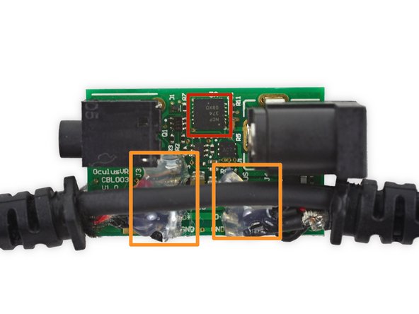

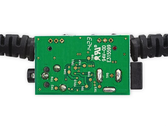

  10. Oculus Rift Development Kit 2 Teardown: crwdns2935265:011crwdnd2935265:01crwdnd2935265:03crwdne2935265:0 Oculus Rift Development Kit 2 Teardown: crwdns2935265:011crwdnd2935265:02crwdnd2935265:03crwdne2935265:0 Oculus Rift Development Kit 2 Teardown: crwdns2935265:011crwdnd2935265:03crwdnd2935265:03crwdne2935265:0
    • Let's pop open the slick new cable hub and find out what's inside:
    • ON Semiconductor NCP 374 overvoltage protection device with load switch function
    • You can sleep soundly knowing that those cables aren't going anywhere, because Oculus didn't skimp on the globs of hot glue on the inside of the cable hub.

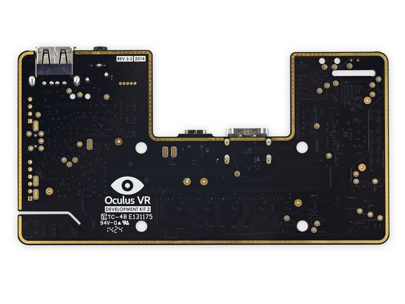

  13. Oculus Rift Development Kit 2 Teardown: crwdns2935265:015crwdnd2935265:01crwdnd2935265:01crwdne2935265:0
    • We manage to liberate the motherboard from the DK2's eyewear enclosure with ease.
    • This motherboard is a major change from the previous incarnation of the Oculus Rift. All of the device's guts are now packed onto a single board, eliminating the need for an external control box.
    • We've got to hand it to Oculus, because they've really stepped up their motherboard design. It's easy to remove, and quite a looker as well. We'll have to see if this Oculus design can stand the test of time and make it into the consumer model.
  14. Oculus Rift Development Kit 2 Teardown: crwdns2935265:016crwdnd2935265:01crwdnd2935265:02crwdne2935265:0 Oculus Rift Development Kit 2 Teardown: crwdns2935265:016crwdnd2935265:02crwdnd2935265:02crwdne2935265:0
    • These are the ICs that make virtual reality a possibility:
    • Toshiba TC358779XBG HDMI Interface Bridge
    • STMicroelectronics STP16CPC26 Low Voltage 16-Bit Constant Current LED Sink Driver
    • STMicroelectronics STM32L100RB Ultra-low-power 32-bit Value Line ARM Cortex-M3 MCU with 128 Kbytes Flash, 32 MHz CPU, LCD, USB
    • Cypress Semiconductor CY7C65632 Very Low Power USB 2.0 Hub Controller
    • STMicroelectronics ST1S31 3A Step-down DC-DC
    • Invensense MPU-6500 Six-Axis (Gyro + Accelerometer) MEMS MotionTracking
    • Texas Instruments TPS65632A Triple Output AMOLED Display Power Supply

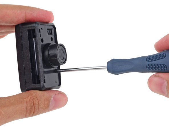

  19. Oculus Rift Development Kit 2 Teardown: crwdns2935265:021crwdnd2935265:01crwdnd2935265:02crwdne2935265:0 Oculus Rift Development Kit 2 Teardown: crwdns2935265:021crwdnd2935265:02crwdnd2935265:02crwdne2935265:0
    iFixit Opening Picks (Set of 6)
    • A sneaky cover plate hides a couple screws on the positional tracker's body, but our opening pick quickly sniffs them out.
    • The promising seams along the side are not for prying—ignore them. Ignore them well.

    • After playing around with the positional camera lens, we conclude that it's a wide angle lens. This allows the positional camera to see more IR LEDs at once, expanding its tracking abilities.

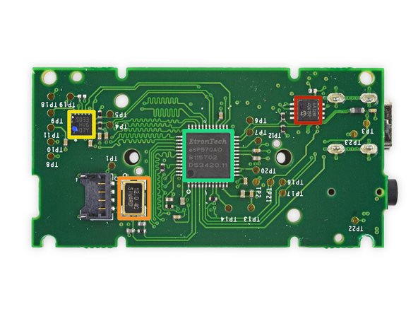

  21. Oculus Rift Development Kit 2 Teardown: crwdns2935265:023crwdnd2935265:01crwdnd2935265:02crwdne2935265:0 Oculus Rift Development Kit 2 Teardown: crwdns2935265:023crwdnd2935265:02crwdnd2935265:02crwdne2935265:0
    • Upon freeing this baby motherboard from its enclosure, we spy the positional camera's CMOS image sensor.
    • There are several ICs on the positional camera motherboard:
    • Microchip Technology 24AA128 I2C CMOS Serial EEPROM
    • SIWARD 12.0 4C Crystal Oscillator
    • S033 HVG 107Y
    • Etron Technology eSP570 webcam controller
  22. Oculus Rift Development Kit 2 Teardown: crwdns2935265:024crwdnd2935265:01crwdnd2935265:02crwdne2935265:0 Oculus Rift Development Kit 2 Teardown: crwdns2935265:024crwdnd2935265:02crwdnd2935265:02crwdne2935265:0
